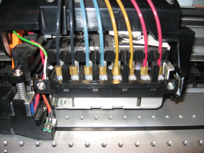

I am having a major issue with our Mutoh VJ-1204 48in printer. I really need some help. I called Mutoh tech support and they said it would be a $500.00 initial fee and then $175 per hr. Whoa, not good. I have prints I need to get out ASAP.
It wasn't printing colors properly the other day and we did a nozzle check and realized that cyan ink was not printing. The suggestions we have heard is to use a syringe to pull ink though the line. I have looked everywhere and can't find the area where I should insert the syringe. I can clearly see that there is no ink in the line. Where the cartridge inserts into the line, I dont see any ink in there either. I wonder if the problem is starting there? Anyways, I am going to post some pics. If anyone can tell where I should inject the syringe, please let me know. I am so afraid that I am going to mess something up, but I cant afford a $1000 tech bill right now. I just want to be sure on the location of where to suck air through the line. Also, how in the world do I get the dampers out?

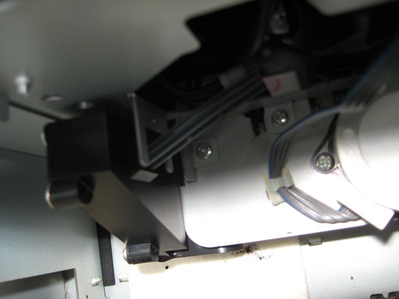

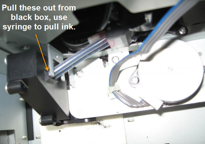

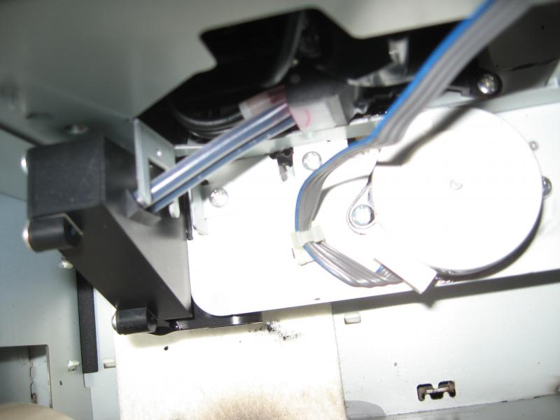

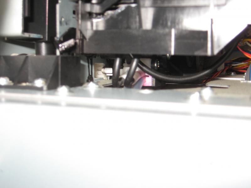

The first pic is where the print head is located of course, and the others are under the capping station. The two lines that run under and into the waste tank. I have heard I can remove those two lines and pull air through but I am not sure about that. Please let me know what you think.

on my mimaki you can take pull the cap station line off at the pump and pull ink there. I would say yours would be the same

the syphon trick will draw ink through- you need to pull out the dampers and attach syringe to base of each damper (where it plugs onto the head) and draw a suction. you'll need a peice of tubing to fit the damper port to the syringe. no needle of course haha!

you pull out one of the dampers and pull the ink from there. also, from the two lines on the bottom of the capping station.
I bet your capping station is completely gunked up.

The print head carriage has a hold-down bracket that clamps them down. You remove the bracket, then gently pop out the damper. They snap in. No need to disconnect the ink line (the brass nut) if your goal is to suck ink out of the bottom of the damper.
In my opinion, it is unlikely that you would have a simultaneous failure of BOTH dampers of any single color. They share a common line to the cartridges and the dampers use a Y-Splitter to feed two dampers with one ink line...
THEREFORE, if (still in my opinion) you have lost BOTH dampers, then your problem is NOT the dampers, but rather something that afflicts them both. IE... air in the ink line, collapsed subtank, or (like I originaly said) a bad/blocked maintenance station (causing the ink line to lose prime)

I lost most of my nozzles (posted in a different thread) two weeks ago and recovered them completely by pulling the maint. station and cleaning the heck out of it. One line on the bottom of the capping station was completely blocked and the other blocked alot. Using a syringe and cleaning solvent I was able to finally soften the ink-plug and clear the lines. It was a tedious and messy job. It was much easier to do on a bench than if it was still in the printer.
For sure you can tell if this is your problem..
1. Remove the top cover so ytou can see what you are doing! then move the head out of the way
2. Use your syringe to squirt some cleaning solvent into the capping station head (to avoid a mess do not overfill)
3. Pull the double tube (indicated earlier) from the drain cup and use syringe to suction one side and then the other. You should easily slurp the solvent out of the cap.
If it is hard to pull then you have a block.
