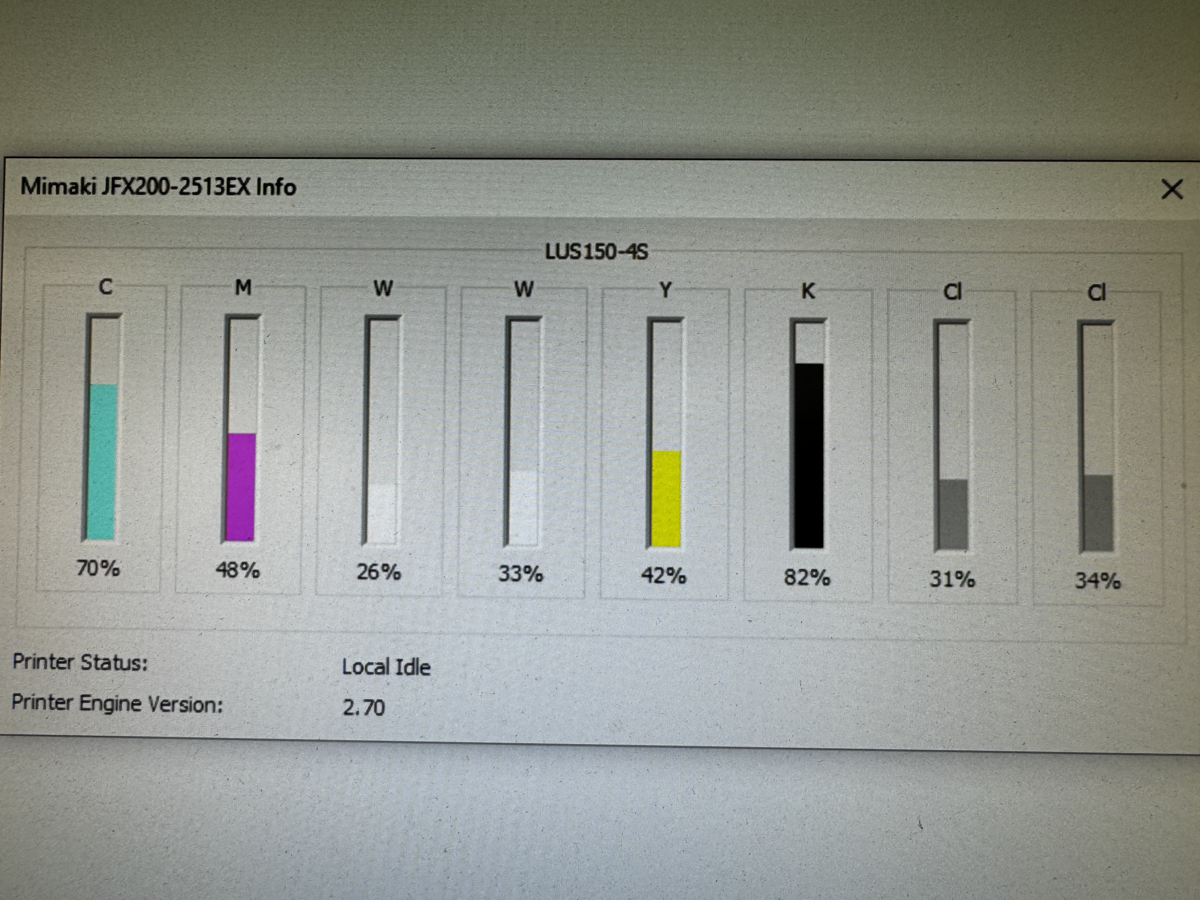

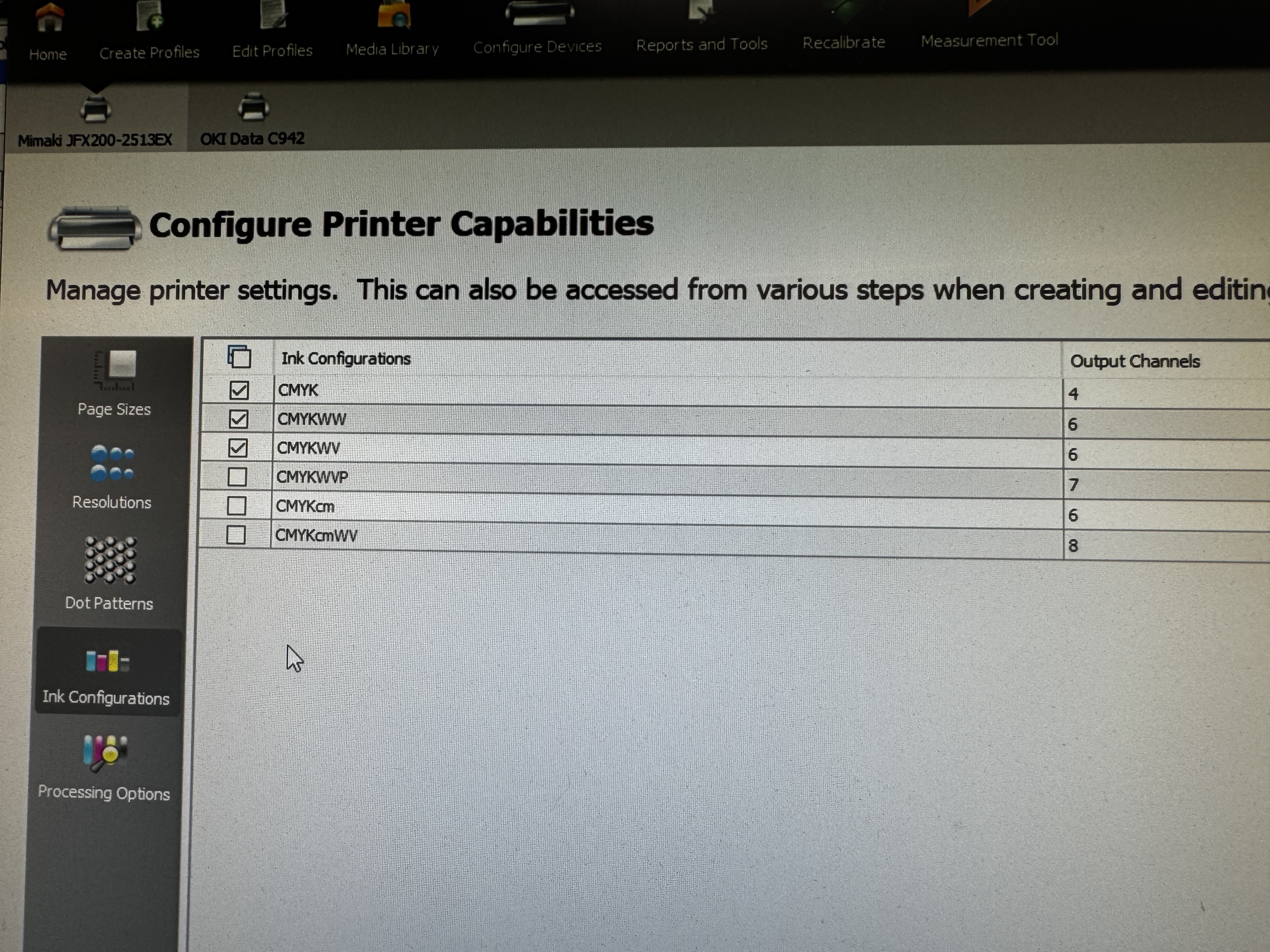

1. I have selected the driver for my JFX200-2513EX. There seem to be only 2 profiles available, both for the LUS-120 inkset, while I have the LUS-150. That's not a big deal as I'm planning to make my own profiles anyway. The issue is in selecting the ink configuration. I have CMYKWWVV, but the closest option it offers is CMYKWV. I would say that's ok but it specifically says 6 channels and I have 8. The only 8 channel options include light cyan and magenta, which I don't have. When I view the machine status, it correctly shows all 8 channels, so it knows they exist.

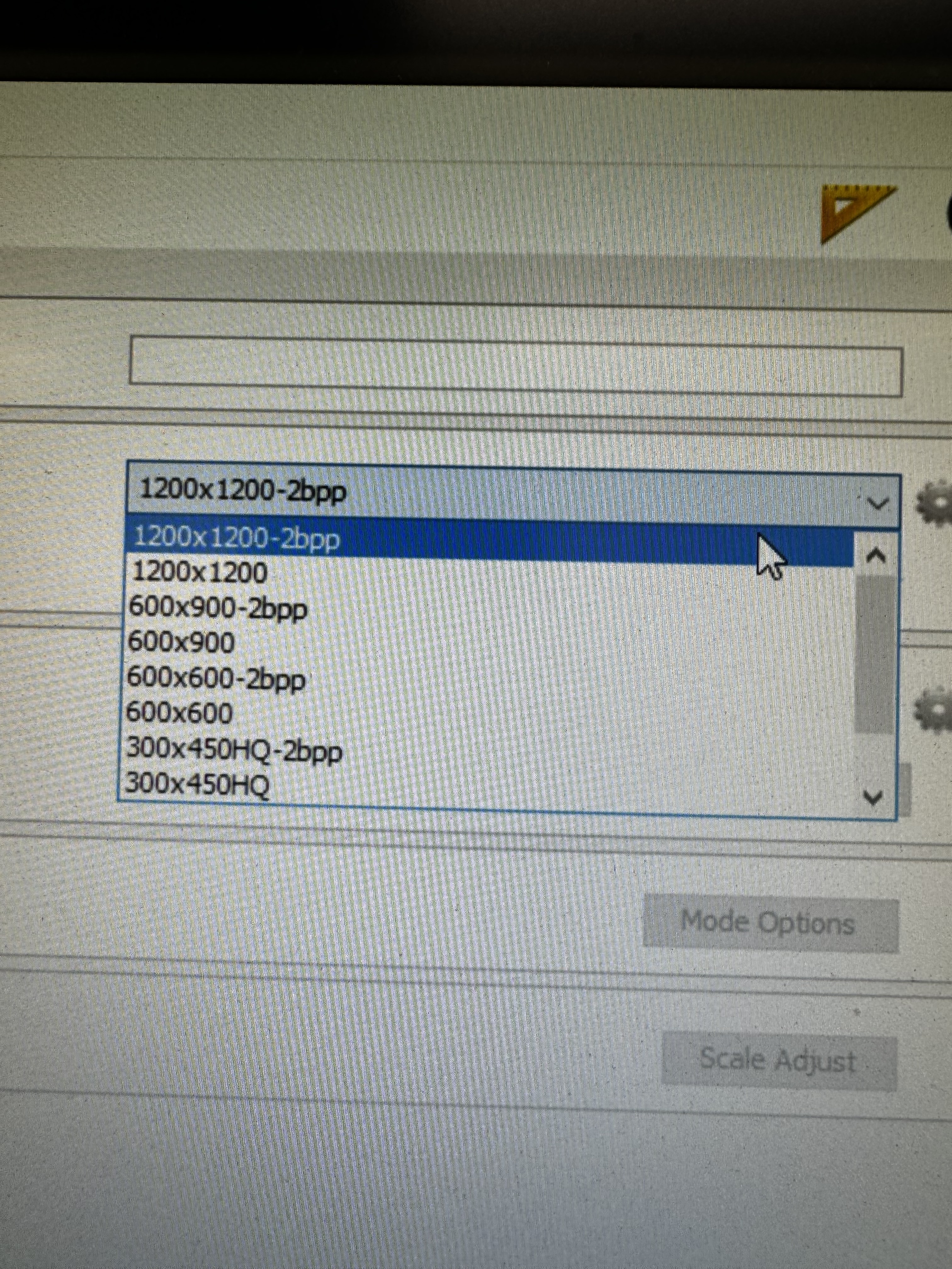

2. Any idea what 2bpp refers to? Possibly related, how to I access variable dot? That's key to getting the best results on this machine. I have tested using 600x600 and the display shows ND which I assume means Normal dot, while it showed VD from RasterLink. I believe Variable Dot is only available in the higher pass count, but even when I selected that, it still seemed to offer only small, medium, large static dot among the options.

I installed Onyx Go Plus today, and despite no apparent documentation being available (for free), I've worked my way through it so far. But I've encountered some issues/questions that I'm hoping someone can help with.
View attachment 173221 View attachment 173222

1. Choose CMYKWV, these are the process colors for your machine. Onyx will send the same amount of W and V to the other channel.
2. 2bpp means variable dot. In the mode options don’t forget to choose FAST instead not NORMAL carriage speed.
