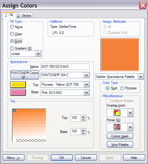

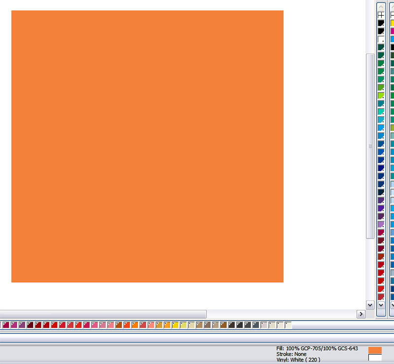

For overprinting, opaque foils would be helpful. On the other hand, an extensive amount of additional colors including Pantone color matching becomes possible by using the Gerber Spectratone palette. With this you can create new colors by automatically overprinting one spot color on another. In the following images, you can see how one can print Pantone Orange 164 C by printing Process Yellow on top of Spot Pink.
attachment.php
attachment.php
To handle colors touching other colors, you should either use the choke/spread feature or a Spectratone setting for the color you want overprinted on Spot White.
