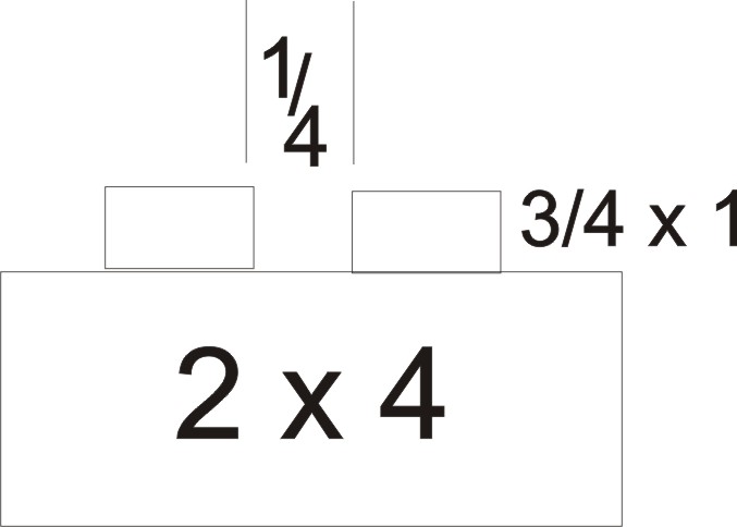

OldPaint
bottom and top 2 X 4.......then find center of the 2 X 4's........get some 3/4" X 1" trim boards, drill holes bout every foot, run 2 lengths of that on both 2 X 4's leaving a 1/4" opening for the alumicore to set in.....same top 2 X 4 and bottom one. i have done a few of these and even here in florida with high winds.....it stayed put.
