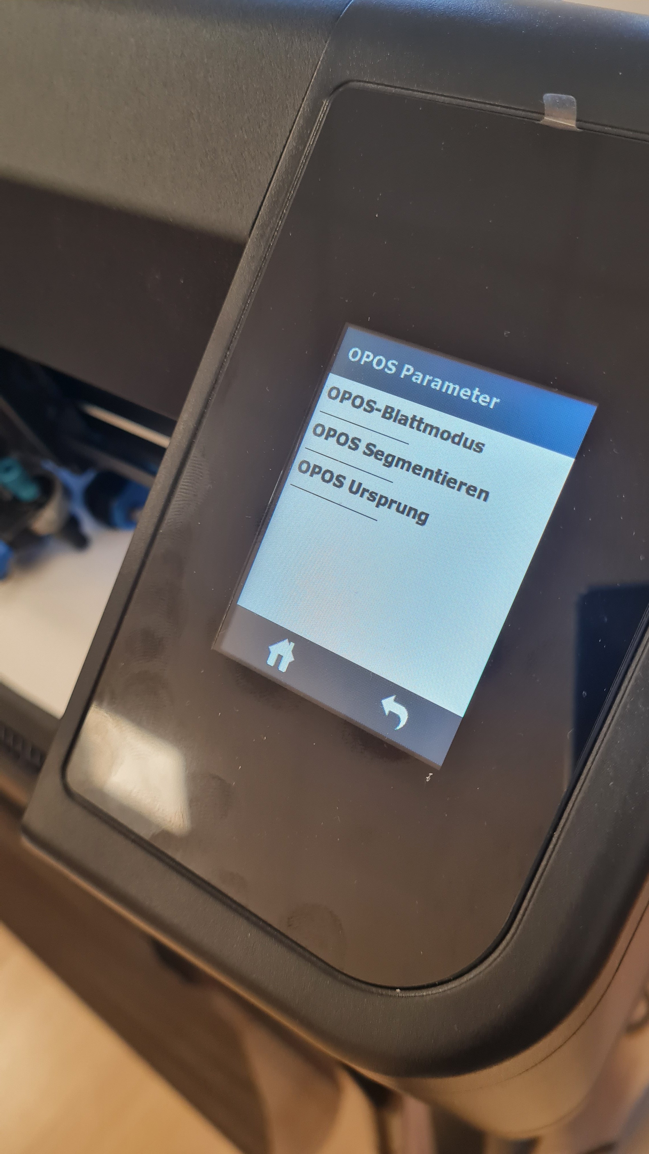

In postershop (21) printed cut-jobs have OPOS xy2 alignment marks. I set "OPOS XY2" with Summa Cutter Control app to send this setting to new Summa s1 but the plotter only reads the pass marks, not the xy line as our old Summacut did.
Is there anything I can ajust in plottermenue directly?

Another view on my post. It's not influenced by onyx rip. The only little problem is "summa cutter control" app what doesn't transfer the change of OPUS to OPUS XY... to summa s one plotter correctly. All other setting transfers work.

You can set it on the plotter display as well.
Thank you, but I don't see it in the menu...
It's a new s1 with latest firmware. (The manual describes it as "International parameter")
