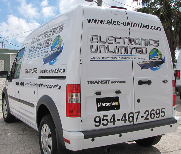

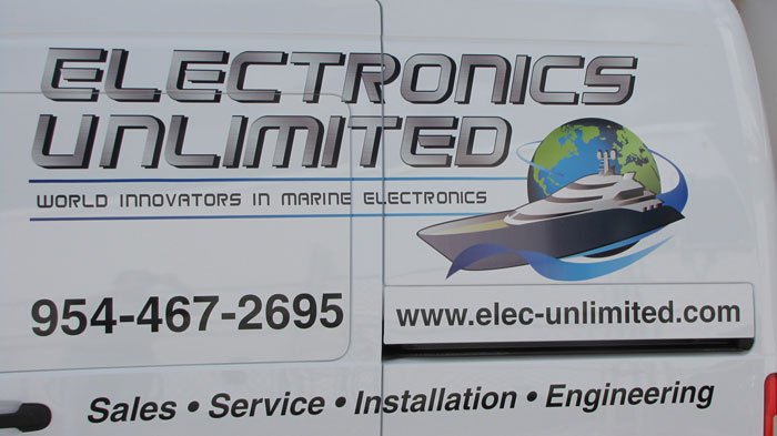

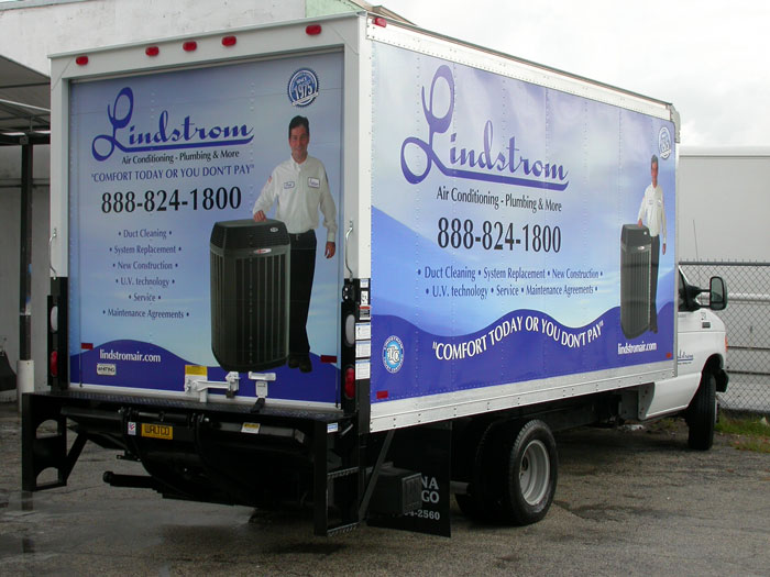

We have used 3551 for a long time and we use it usually for installations as shown below. We have some of this out there for 3 years now without any trouble. we also use Arlons 3450 and have had matching results. Always using matching laminations as well. the only place we won't warranty is on the hoods. Most of the work we do is for the trades and they turn there vehicles around every 3 years. When you have a fleet of 80 plus vehicles this will make a difference.
