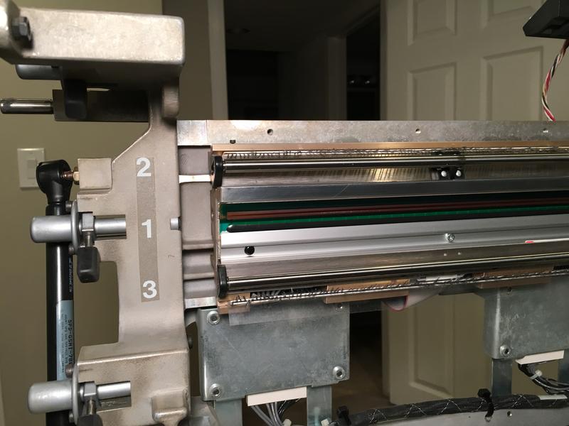

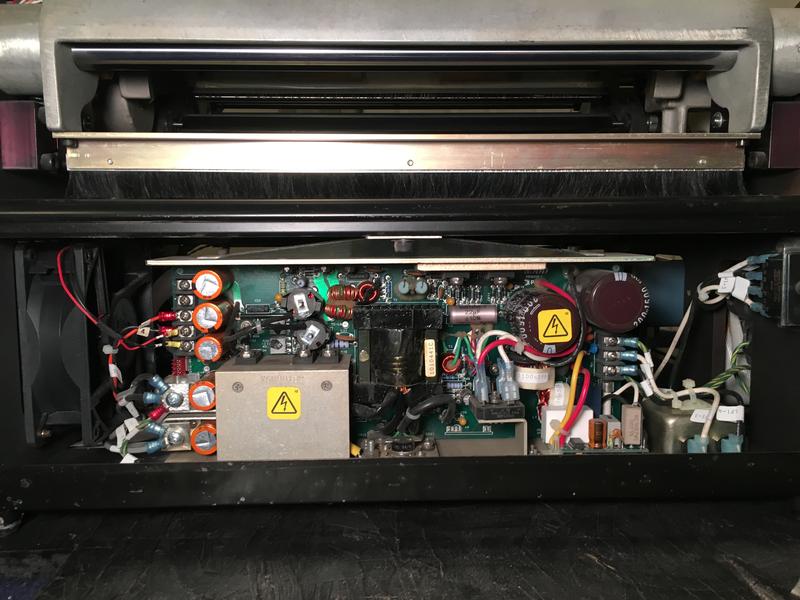

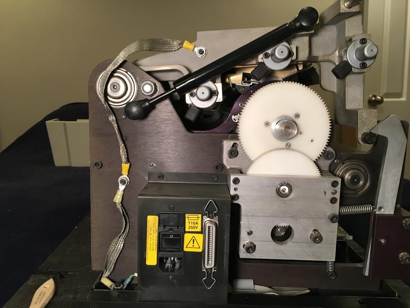

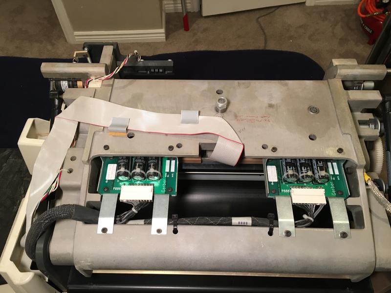

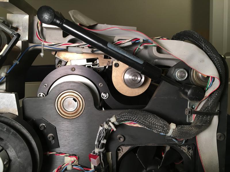

I was cleaning my original Gerber Edge - I use this machine as a backup ( rarely needed). I replaced the shocks- and then decided to pull the top cover off to epoxy repair a few cracks, and replace felts that align the large pins for the print head assembly.
I then decided to remove side covers, front and back covers for cleaning- this thing was very dusty dirty.
no particular purpose for the pictures- but I like others am amazed at the engineering and "toughness" that went into this small machine:
enjoy:

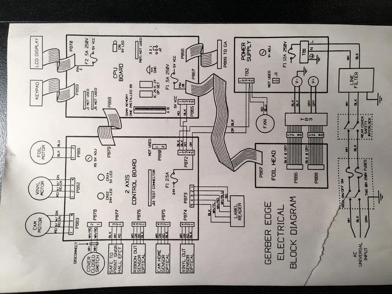

And a Wiring Diagram:
