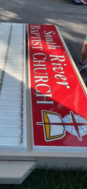

Looking for tips on how to replace this backlit signage (removal of old and replace with new printed vinyl). Is there a vinyl that is able to be applied to the inside of this or will I need to reverse print this? TIA

More than likely that is reverse painted. In my experience most vacuum formed pan faces are painted from the inside. We have a few wholesalers that do vacuum forming, not a common thing for most folks to do in house. I am sure the technology has changed since I knew what I was talking about so some of it might be digitally printed these days. You could always do a flat face (might get lamp lines as a result) and decorate it however you want. Or you could buy a white pan face and put graphics first surface. I always felt if I had to buy a custom formed face from somewhere else I might at well have them paint it too.
