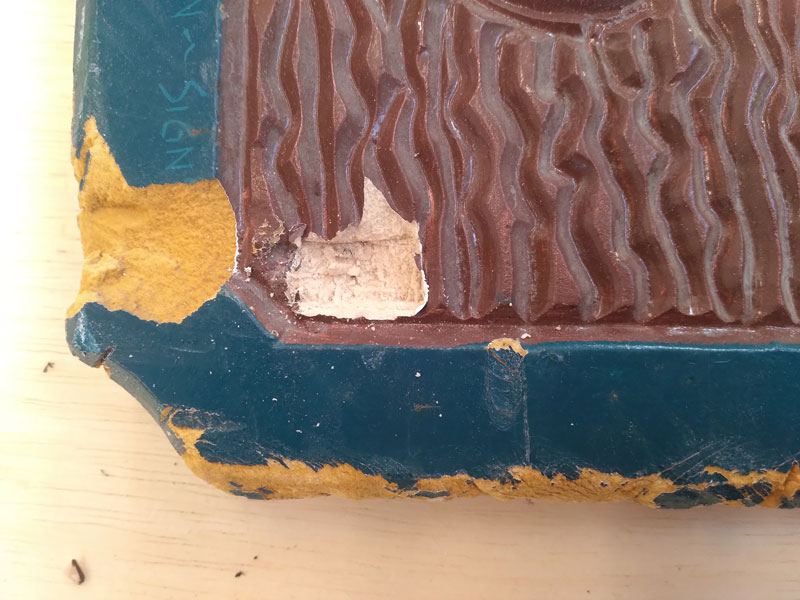

I have left HDU unpainted in the weather and never seen it fall apart even after several years. The surface discolors, but the discoloration is only an eighth of an inch thick. The sun can burn a hole in it? Maybe the brands vary in their UV resistance. Maybe the density makes a difference. Yes, HDU is kind of crumbly by nature. And I noticed scraps that looked bad after a long time, but when I cut them they looked okay on the inside. If someone has actually seen the sun burn a hole through it, that's a new one on me. But my experience is anecdotal at best. I believe that Coastal Enterprises merely claims that it "lasts ten times longer than wood."—part of their lifetime guarantee.Many many years ago, I was visiting a shop in another state who majored in HDU signs. They told me, the sun will kill bare HDU. Ya need to make sure it's completely covered and covered well. He said, they get more work from repairing these signs because of stones or whatever hitting these kinda signs and chipping the paint off and the sun will eventually burn a hole in it. You're saying this isn't so ?? I'm questioning, as I never had it happen to me.
