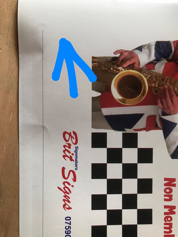

When i print sometimes it doesn't print a line all way around the print does anybody know how to fix this please

Go into your Queue settings and set an EPS margin. Its under 'File Format'. I have mine set at .1 inches. I think as long as it is a number greater than 0 it will do the trick

Tks very much I will try it tmoz it used to be fine

Yes, set an eps margin larger than 0. Should do the trick. Sometimes i have not been able to set it in the job, i have my default settings set to 1 so anything i bring in to print will take the setting regardless.
