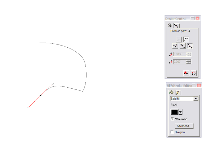

I think the main issue with Flexi's bezier pen too that a user needs to adapt to is that it defaults to a symmetrical control point when you draw. Thus pulling at the length or angle is affecting both sides of the curve at the same time. It would be much more useful and intuitive if it defaulted to just a smooth point.
The control for this is most easily established by having the Design Central module open and handy so that you can simply click on the kind of control point and/or segment desired as you go. You can also accomplish the same thing with the Alt key but it is considerably less intuitive than is the Design Central IMHO.
My general approach when hand drawing with the bezier pen is to mainly focus on where I want the point to be and at what angle. Then I do an editing pass after laying down the object to finalize what I want. It just seems to be the most efficient way to get a quality vector in place.
