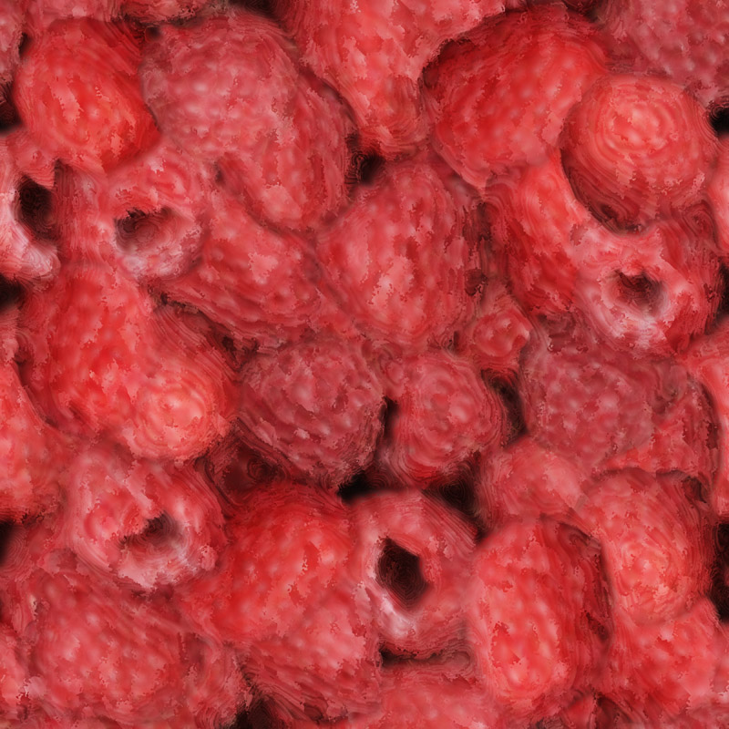

A few suggestions for using Filter Forge with large files:
  • Not all filters are created equal. Those which use lighting and blurs are slower than those that don't.
  • Anti-aliasing is commonly defaulted to. Turning it off when rendering will reduce render times dramatically.
  • Render times are improved by using Filter Forge as a free standing program rather than as a plugin because more memory in available.
  • When rendering, be sure to select only an 8 bit per channel color depth. Greater depths = larger, slower renderings.
In the file attached, I rendered the image at 3,600 x 3,600 using Filter Forge and this filter. I followed the above listed guidelines and the rendering took just under five minutes on a quad core with 4 GB of RAM. My image size is about 90% the size of yours so it should be fairly comparable. Even allowing for a single core machine and the slightly larger pixel dimensions, I would expect a render time on your machine of less than 20 minutes. Attachment #1 is the original and #2 is the rendered version ... both scaled down for display in this post.
