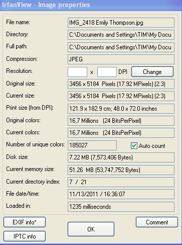

graphix
this is the size and don't know what all it means...thanks for helping i just thought 300 dpi would help with print quality picture will be for a 4x2 ft banner..

oldgoatroper
Roper of Goats. Old ones.
Well, there ya go...
Absolute size of your image is 3456x5184 pixels. If you are going to print this image at 100 pixels per inch (ppi), then you could print it at 34.56" x 51.84 inches. Simple as that.
Of course, if you were to print that image at a smaller size, then its ppi would go up correspondingly.
Extra note: though we often say dpi (dots per inch) when referring to digital images, we really should force ourselves into the habit of using pixels per inch (ppi) as that is the proper reference.
Dots per inch (dpi) is really a designator of another property of printing processes which is beyond the scope of this discussion.
