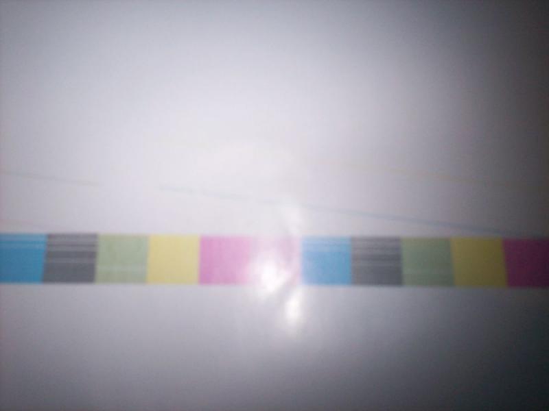

Ok, this is the nozzle test on our prismjet extra. Figured I would ask the experts here what their thoughts were before diving into the manual. Thanks for the help in advance.

Run some cleaning cycles, it should clear up.
laserman70
Thanks you guys are the best. Are you speaking with the cleaning cartridges? or just normal cleaning? thanks again for the help..
Steve C.
Just a power cleaning not with the cartridges..sometimes its faster to print
a large patch of whatever color you are having problems with. I set up a
page with 4 rectangles, red blue yellow black and print them with all colors
set at maximum.
