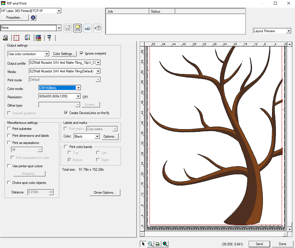

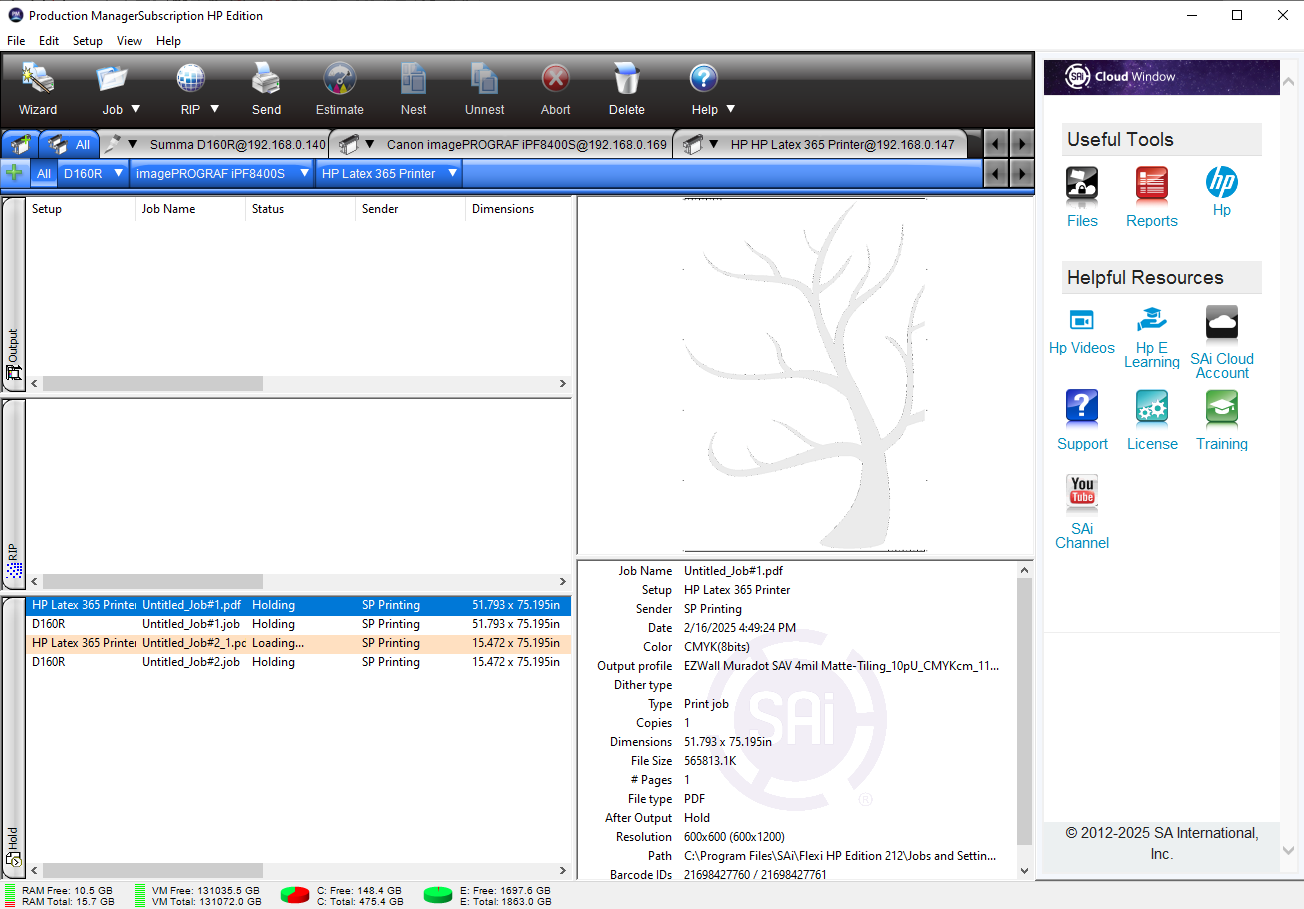

I have to print and cut a two-tone brown tree. When I send it to PM to print it comes out grey. See pics of the Flexi and PM pages.
I probably hit a button somewhere but can't seem to sort this out.
Any thoughts?

Might be some type of mask or filter on the image that Flexi has a problem with
Before I took FrankW's advise I re-built the file and was able to go from there. I did check the original file and couldn't source the issue. Ultimately dumped it figuring it was corrupted. I've had a few files like that this month.

All are fine, did a cleaning, etc. before starting another project. This was a problem at the computer end of things,
