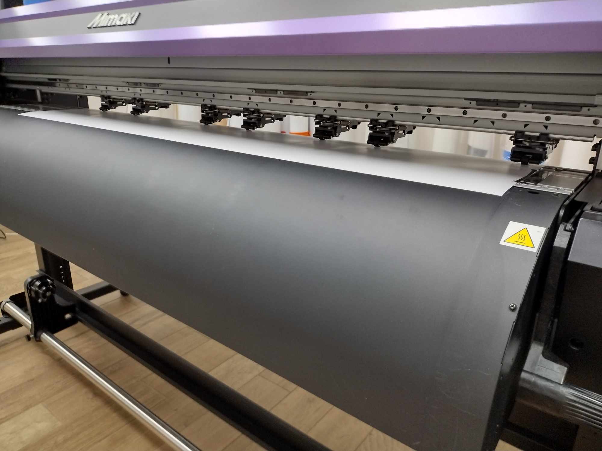

I can't tell you the last time these have been moved at all, except the last one down one more spot on the rare occasion I run 60" material. Set em' up right and all you have to do is just activate 6 rollers for 48" or 5 rollers for 36" instead of 7 when you do the material setup, that's what that option is for. There's really no reason to move them all the time. The only exception may be when running an odd size of certain banner materials that like to bunch up.
