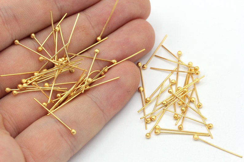

in theory, you could use those big fat pinheads and physically jam "beads" into the wall with a paper pattern.
maybe predrill the pattern with a shallow countersink so only the top-half of the bead is protruding.
the lettering is then tape/pin mounted, and they'll never be able to paint the wall again without extreme difficulty ...so make sure you're firm on install after their final paint job has time to dry.

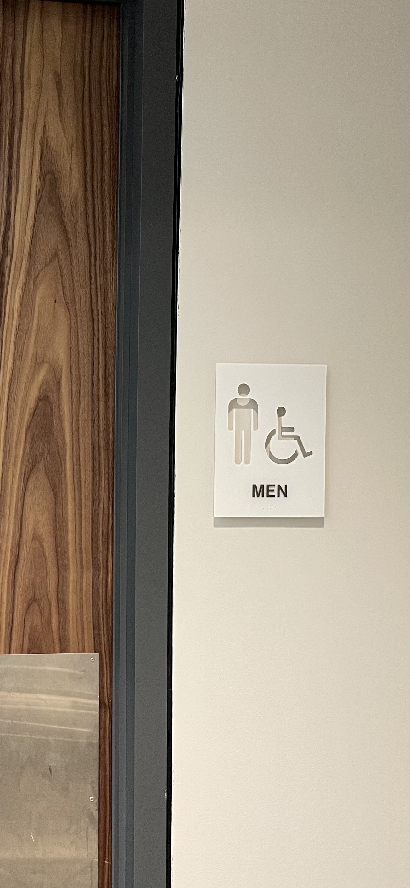

Had an architect with a similar big brain idea, all the signs were matched to the interior paint and mounted with quicksnaps for a floating look, with characters cut out. Install was a pain, as each sign has 4 mounts that had to be drilled and anchored, otherwise the snaps would pull the backs portion off the wall.
Ya know one of the main rules is to have around an 80% or 90% contrast. That's not even close. Not everyone that's blind see black. Some can see slight shadows, and still read this braille, but again, that hairbrain idea defeats the purpose of helping the handicapped blind.
