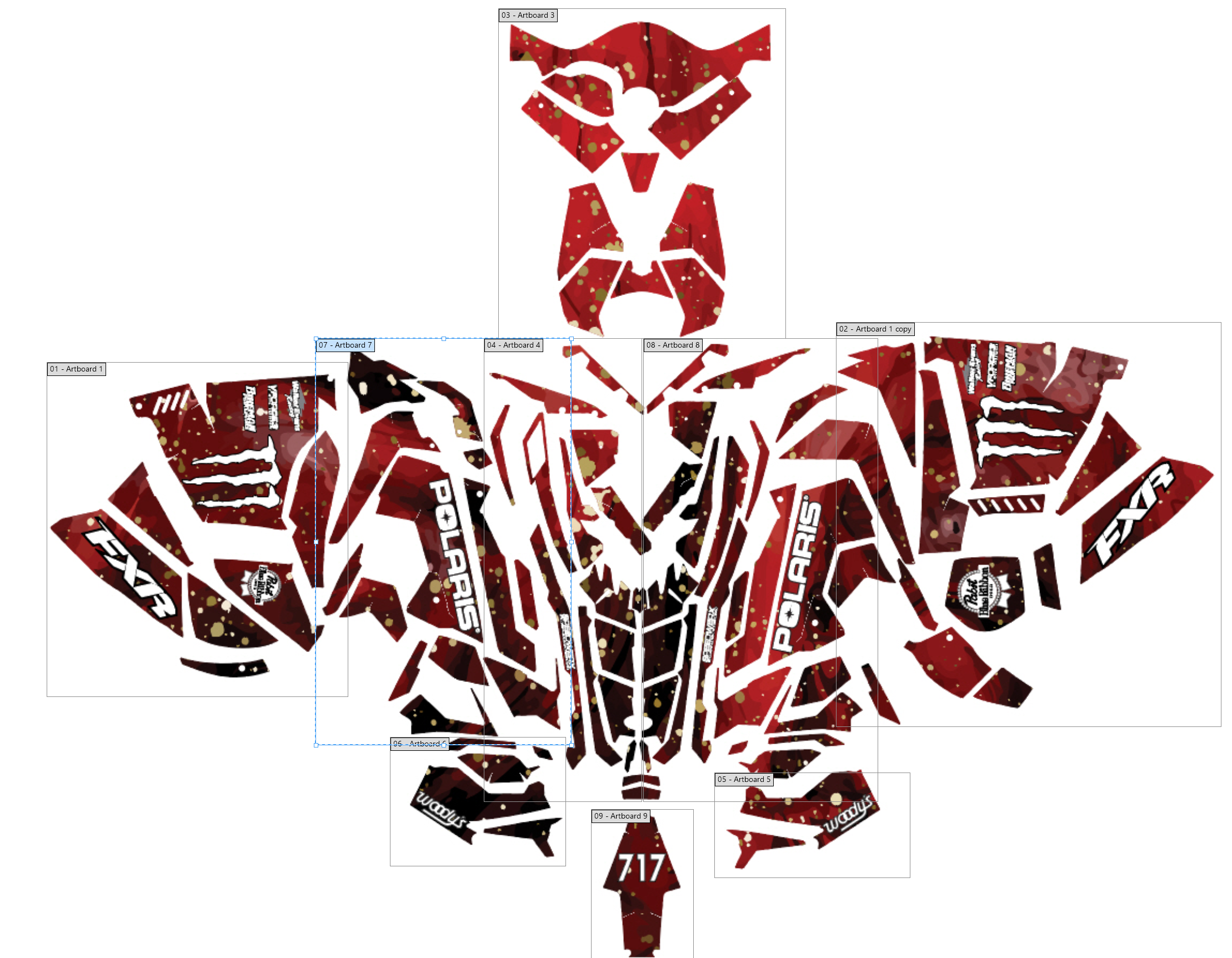

victor bogdanov
Create an arboard for each section of the design, export the artboards as pdf ( draw the arboards all in one file, artboards can overlap etc)
You now have artboards that contain a whole section + some extra from other sections. Print the files as is , cut away the partial/incomplete sections.
That's how I would do it. The little bit of wasted material is not as bad as time wasted trying to nest it all together perfectly
Rough example:
