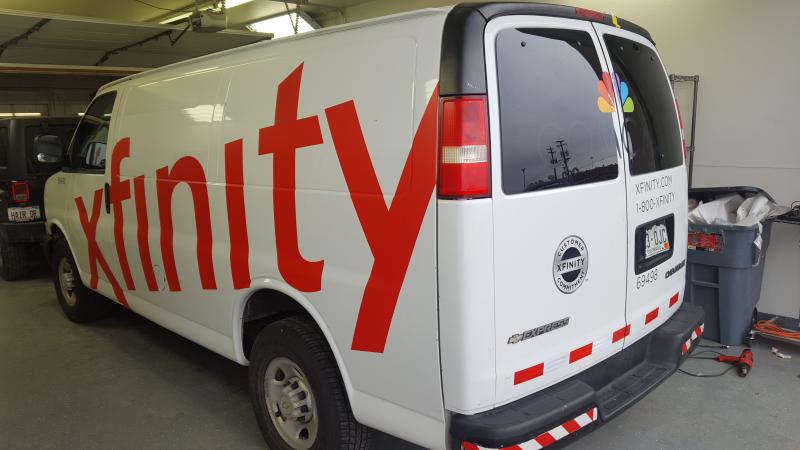

I have a body shop account that needs me to remove and reinstall vinyl just like this van. Remove the same amount of lettering and re install it. I guess comcast has everything pre cut and just sends them out to the shop when they are in need of new ones. So it would just be for the labor. What do you guys think I should charge. I dont want to charge to0 little and also not be outrageous on the price. Any ideas? Thank you

Looks like about 2 hours total from getting your tools out to erasing any guidelines. Removal would be strictly T&M.

What method do you have to remove the old? I might be inclined to price the removal/clean up separately from the new install. I would also make sure none of what you are removing is reflective.
2B
removal is by time * shop rate.
installation 240 ish and then adjust after the first
printhog
Comcast pays from $100 to $250 per install from my experience, but that was years ago. So a body shop? Its likely insurance work, so I'd bump it by $100 or more. its a one off. Removal will be easy, Comcast specifies 3M. likely under an hour to strip.
S'N'S
I do heaps of panel shop insurance work and never do the removal, that's their job.(unless you want the extra money) I just measure up/ take photos and come back the day after painting (oven baked 2k paint) and slap on the new one. If its baked you don't have to wait...BUT you will get all the people crap on about outgassing etc which may be the case for naturally cured, in which case I wait 3-5days depending on how hot the weather is.← Just remember this, cause if you mark the new paint, who is paying to redo it, your $250 is gone (is it cured in the sun or oven?)
If they supply graphics $200-250 to apply
Removal $150.
