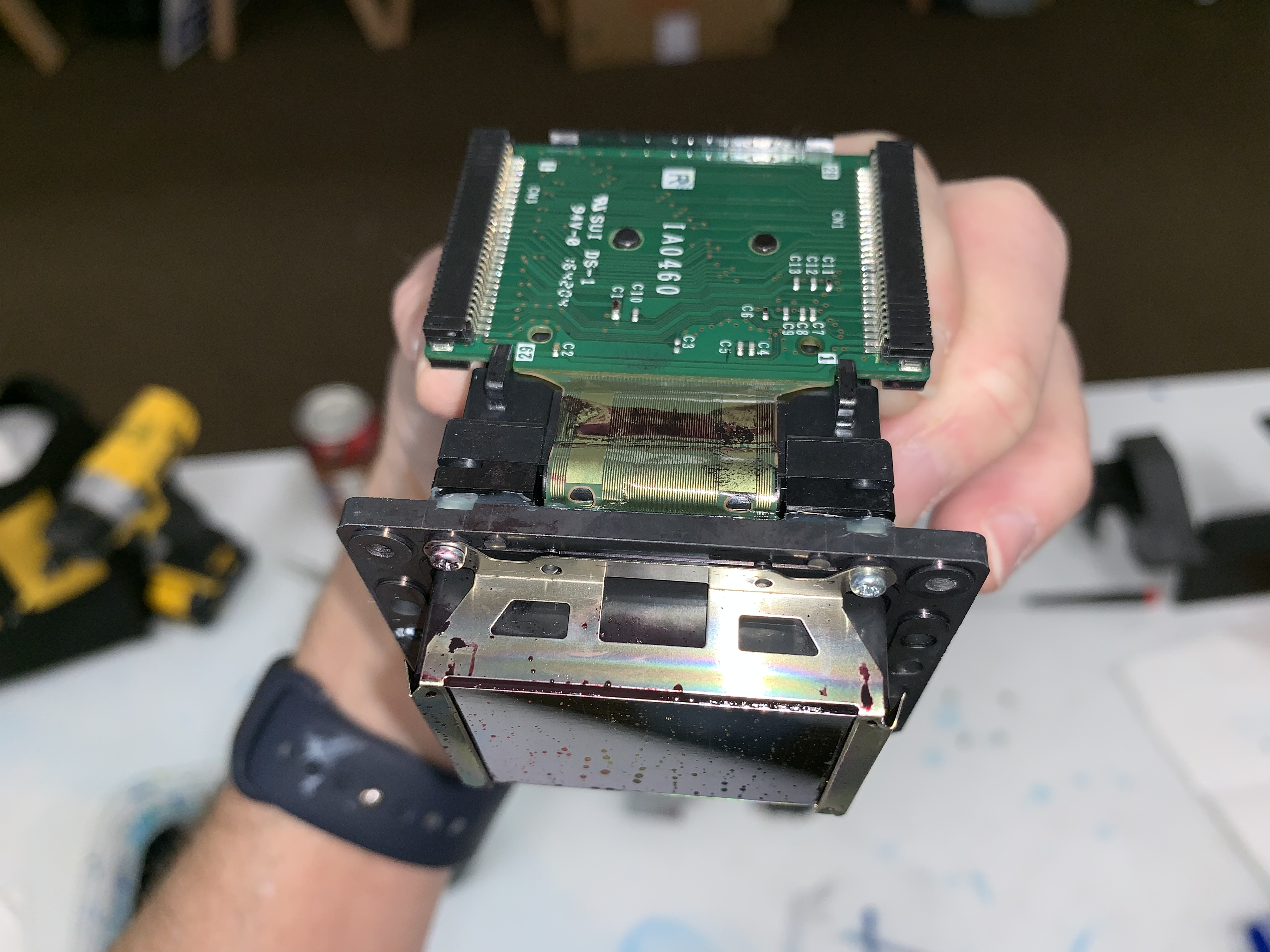

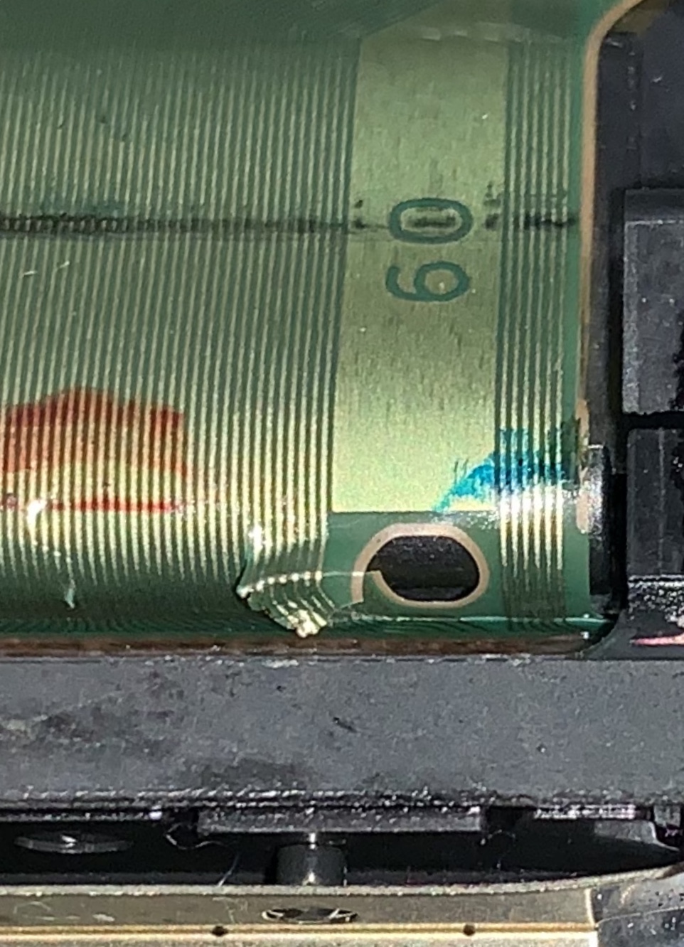

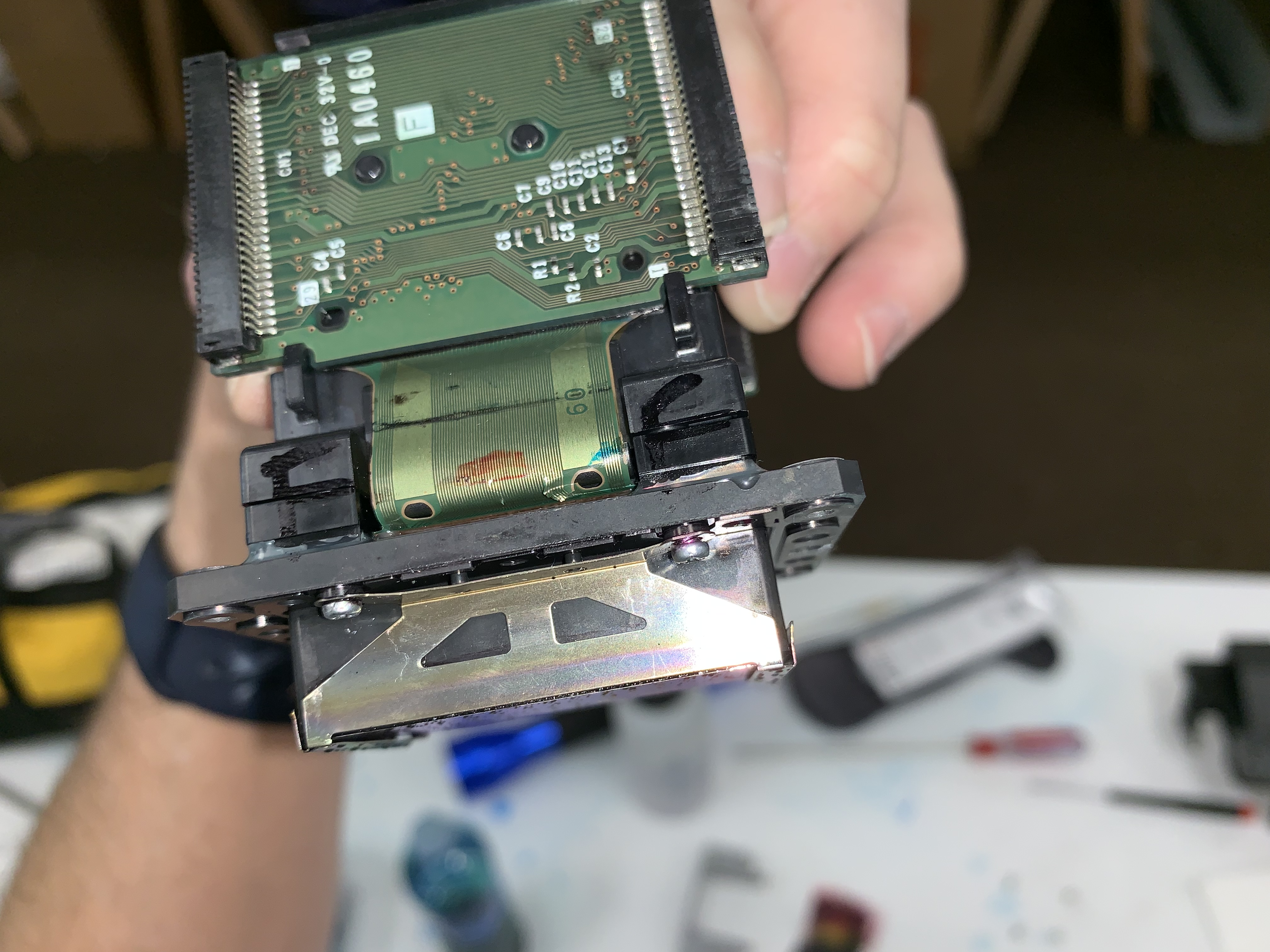

These are photos of a head from a Mutoh VJ-1324XS that wasn’t printing well on some channels. I quickly saw the ribbon was torn on BOTH sides! I’m surprised that it still prints anything. (How do these ribbons usually get torn?)
I didn’t remove the head off the manifold to see if the ribbon was soldered to the head. Are the torn ribbons (and the connector board soldered to the ribbons) replaceable? I only see the entire head assembly for sale.
GatorTPK
looks like you have had a lot of head strikes
only way is to repace the hole head
Thanks for your comment. I was afraid of that, needing to replace the whole head.
You mentioned a lot of head strikes? As in the head hitting something while printing? Before I saw the printer, the owner said someone else had attempted to fix it. We were thinking that person had accidentally caused the damage trying to take the head apart. Could head strikes while printing really cause that damage?

i would be tempted to try and dismantle the head if you can get the cable out without damage then find a old head for the cable
drying up in the mean time could be a problem
only by the head from tried and trusted dealers yes they are ridiculously expensive

Unfortunately that cable is hard wired into the head. Also, $500 for a DX7 is almost certainly a scam but if you go for it and it works out let me know!. Here is a link to the head on our website. We are the only dealer in America selling OEM heads from Mutoh America at this price. Everyone else is either higher priced or the head is from overseas. The head also comes with 4 free dampers, which normally run $140 each, and free phone tech support from 3 full time certified technicians.
