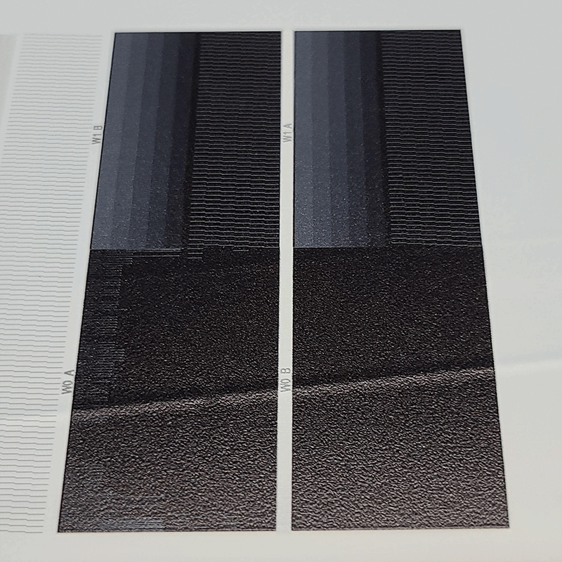

We have a problem where we can do a purge on the white heads and see a nice even flow of ink come off all heads into the tray but when we run a nozzle test an entire head might not be firing. And then with some cleaning work, printing white swatches, etc we will eventually get it back. We have bled the filters a few times. Puzzled by how it seems to flow nicely in the purge but shows nothing in the nozzle test - could this be a voltage issue on an old printhead?

If the problem is visible only in the W channel, it means it's somewhere in this channel. When the nozzles are gone, is there any ink on the nozzle plates of the head? Do you see any ink in the vacuum tubing above the heads? Is any ink spilt under heads after the long idle time?
D3D
There is ink on the nozzle plates, in fact I can get a good looking purge. Which I think rules out the nozzles being clogged.
AlsEU
White ink is the heaviest ink of all colours. Maybe you have a meniscus vacuum too weak and it can't keep the ink inside the heads.
D3D
Is there air trapped in the head/lines at all?
As a means of troubleshooting I have been bleeding air every morning. Since then I have not had the head go out completely, I just struggle with more ordinary groups of missing nozzles that I can eventually recover. Might be multiple things going on, perhaps air in the line + old print heads. Not sure about the meniscus vacuum being too weak, it doesn't drip ink or anything.
