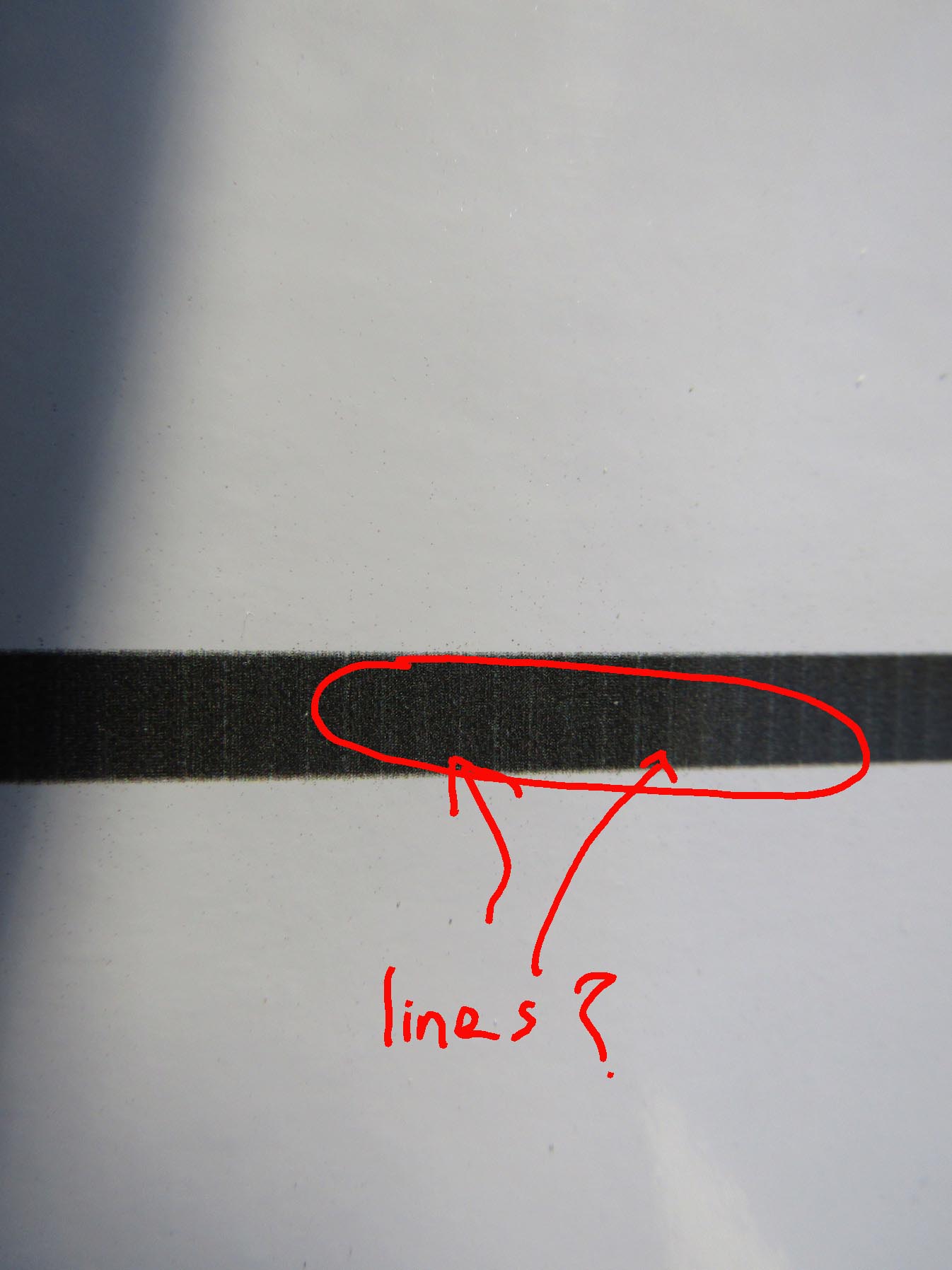

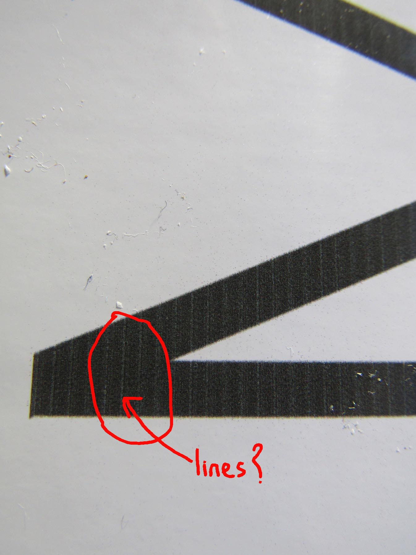

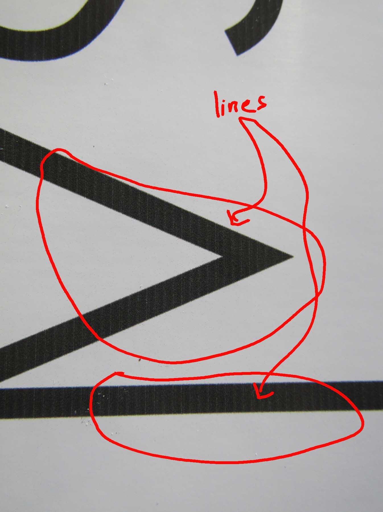

Hi there. Getting this. See photos. Oldish Mutoh. (running via ColourGate). Horizontal lines. Trying to do a high end sign. It will be viewed close up. I know I can fix by uping the ink (say going from 8 pass to 9pass).
but this will obviously make it darker and customer has already ok the colour. I have tried different media, with a small amount of success. The photos are a gloss 5year vinyl. Any thoughts? I'm sure there is a setting ( either on the Mutoh it's self or on ColourGate) even if it does not fix completely? but anything that would help would be fab?. thanks Simon

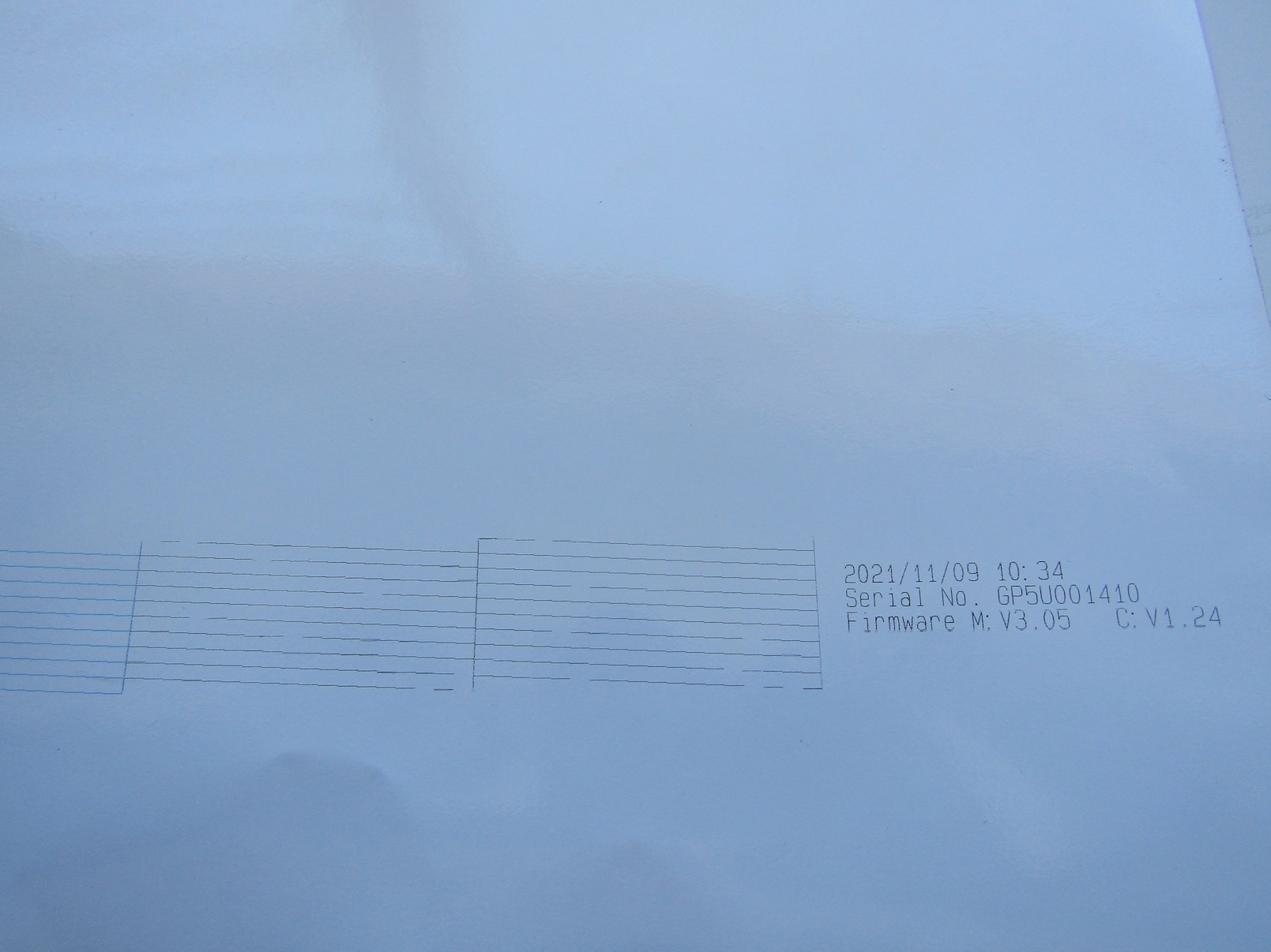

No its not 100% missing a few small gaps on the black (see attached) I keep doing cleans (long and short). I cant find any setting for a power clean.
ta simon

That's fine if you're not comfortable with it. It is unfortunate to hear about the other head going bad. A head soak shouldn't involve any touching of the head plate. Just filling up the cap top with cleaning fluid then parking the head back on top for a soak.
If you're concerned only about this particular job/print, just crank up the passes and try a small test print for colour matching and hopefully you can get something passable.

Ok have done what has been suggested here (in red) so many times. Almost know difference
https://techsupport.signwarehouse.com/cleaning-clogged-nozzles-on-value-jetprismjet-printers/
But having said that this video is not very clear, maybe I'm cleaning the wrong area?. I have used heaps of cleaning fluid. Fab if someone had a link to a better/clearer video.

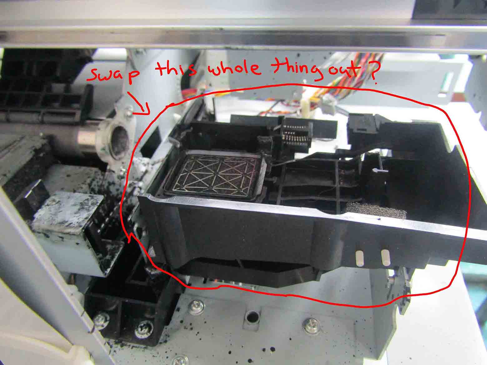

I have an identical Mutoh here (just for parts) How hard is it to swap this whole area out. (see photo), just a thought?
ta Simon

the cap top is that rainbow colored square
