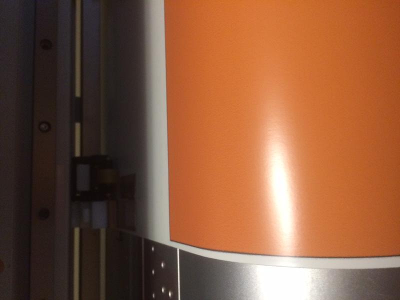

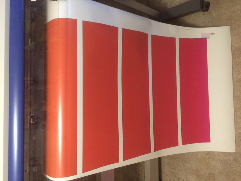

This print is walking off the page.... Is it a common problem?
All I did was repeatedly printed the same box and its flowing right off the page and I dare say it will print onto the machine itself if I just keep letting it go.

Turn off power... lower capping station... take off side covers and top cover.... clean encoder left side then slide carriage and clean encoder right side....
Sound right?

OK!!!! ALL FIXED... PRINTING STRAIGHT DOWN THE RUNWAY!!!!
WHAT A MESSED UP COINKYDINK.
That problem flared up simultaneously during another problem i was fixing at the time.

Glad that worked for you. Next time you clean it you shouldn't have to really take anything apart that I remember (at least from what I remember back with I had an SC540). Just raise the cover and clean the encoder. I loved my Roland printer but it did seem that once one problem came up another one was shortly behind.
