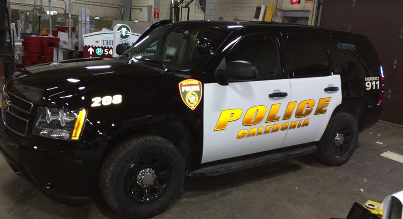

yeah, I print on yellow reflective. with GREAT success.
