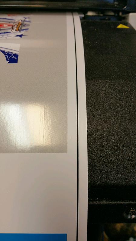

Edit: Also now every time we print something it prints a solid black line down the egdes....?
102RCR
AF thank you for responding. I have calibrated the display multiple different ways and have also switched out diplays. That's about the only change to the system that had been made before the issue until now. Even after doing a factory default on everything. It is still printing black line down the edges all of a sudden.

Rjpw it's on both our Mutoh 1204 and Mimaki JV33 Test prints look good. mutoh is missing a 2 or 3 on the black, Mimaki is perfect.
