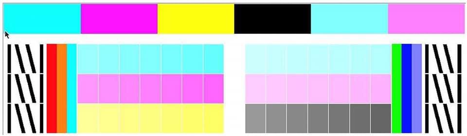

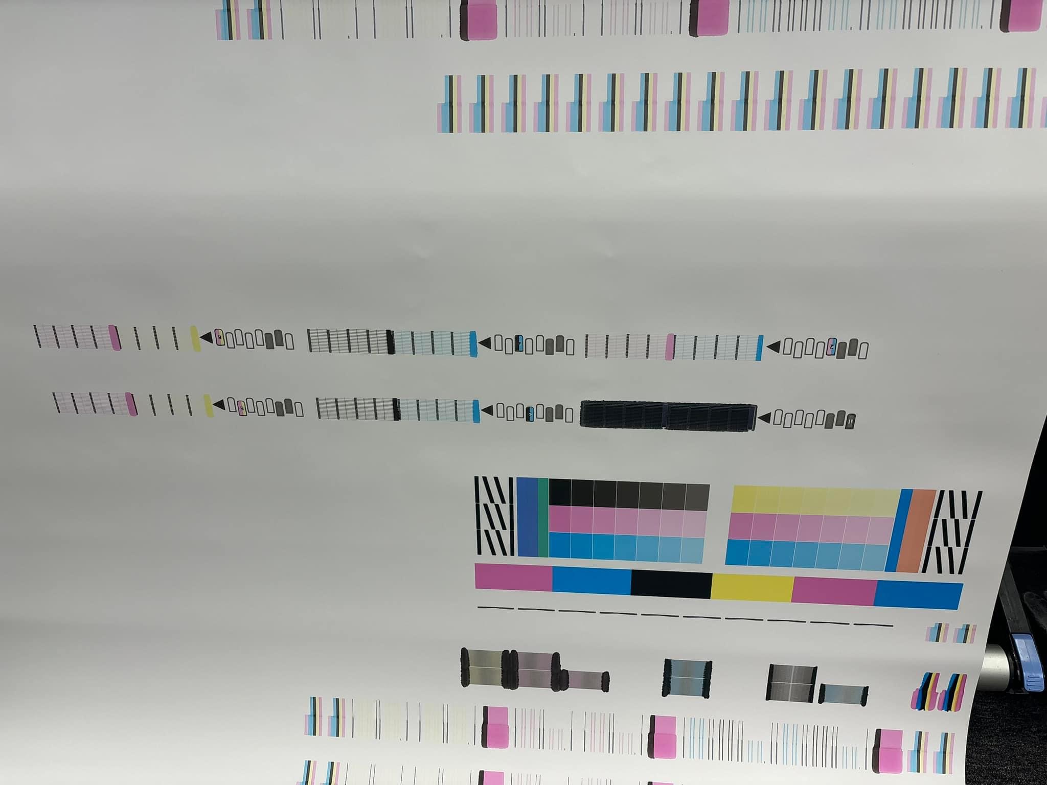

I have a latex 360 and it just will not print red and I have tried multiple files I have done a head clean and calibration, mine is the first image, and people are telling me that’s ok but should it not look like the
Second image? With a red stripe in? The roses should be red!!!

You should be able to see a obvious difference between the light magenta ink and the magenta ink in the color calibration, with the non-light inks having more optical density than the light inks. If the Magenta ink is significantly expired, replace it with a new ink cartridge - but be aware that there are about 30-40ml in the ink delivery system.

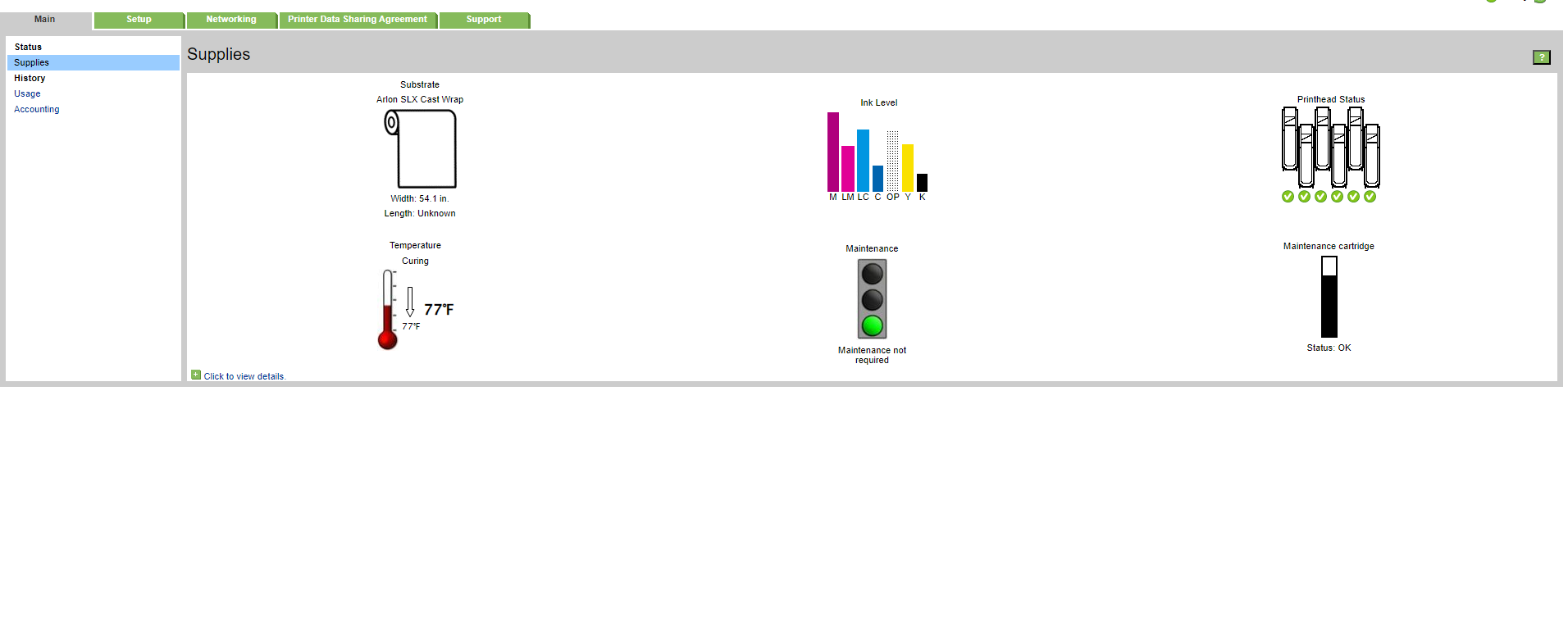

are you able to look at the printheads through your browser? You should be able to see your printheads and inks and how they are firing.

Your full magnets does look light on.
But you are able to print red in your test print.

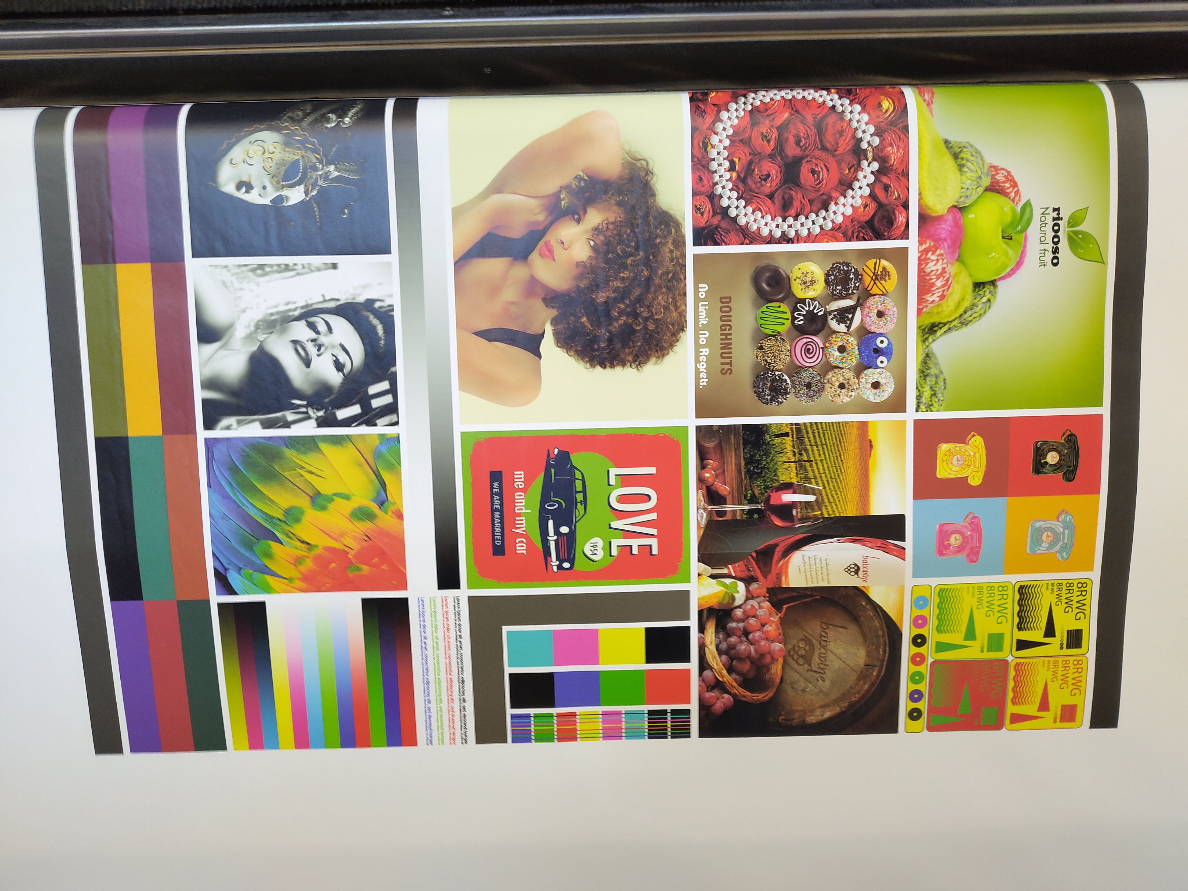

The cartridges are slanted downwards a little bit on the HP 300 and 500 series. If there isn't enough ink throughput, the heavier pigments sink down and are consumed first.(if the cartridges aren't shaken every month or so)
You can shake a cartridge as long as you want. When the pigment-heavy part has been used, they won't come back...
By the way, this is the testprint I mentioned. (I had to repair a l360 this morning an took a picture while testing the fixed printer )
