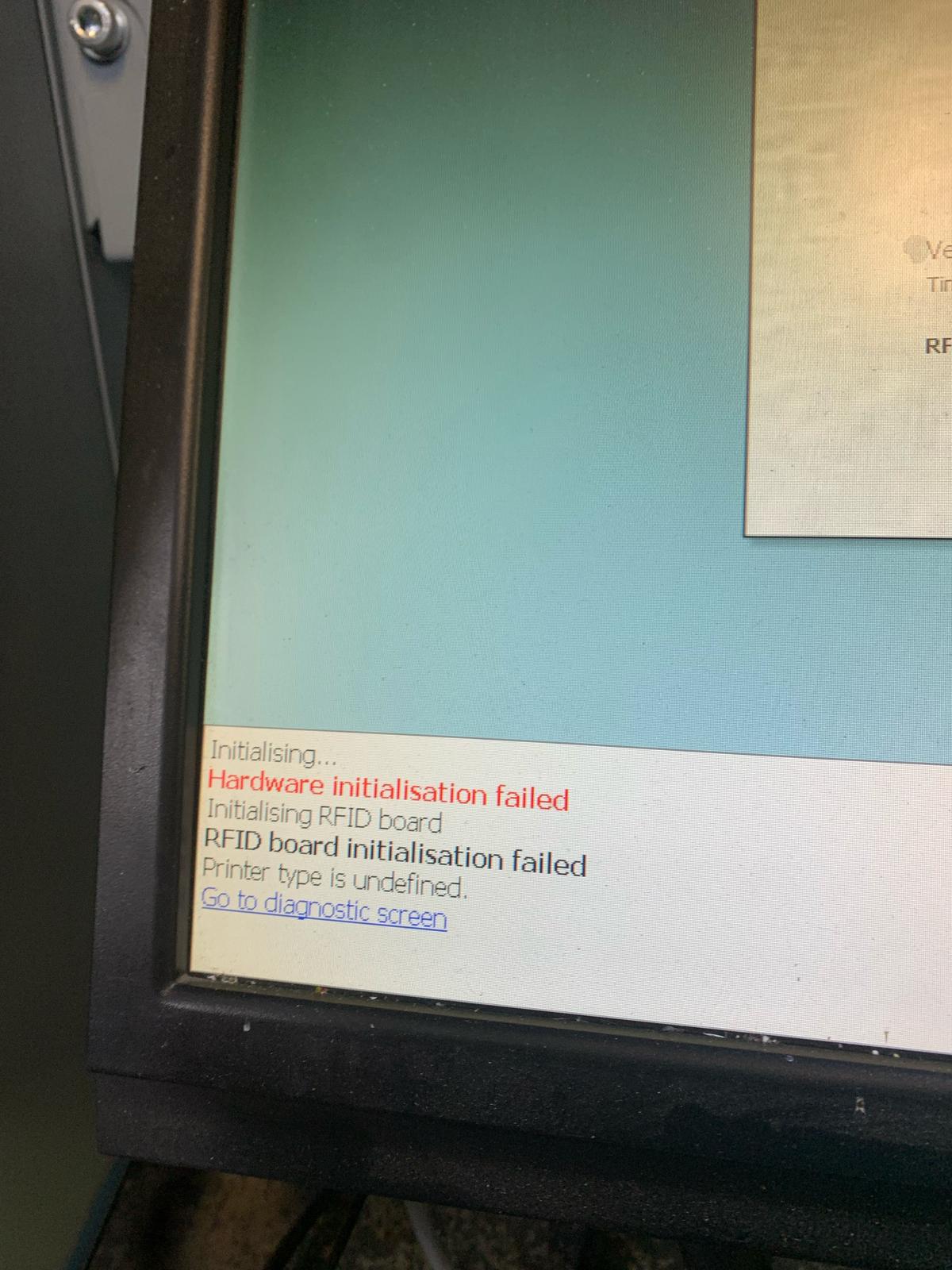

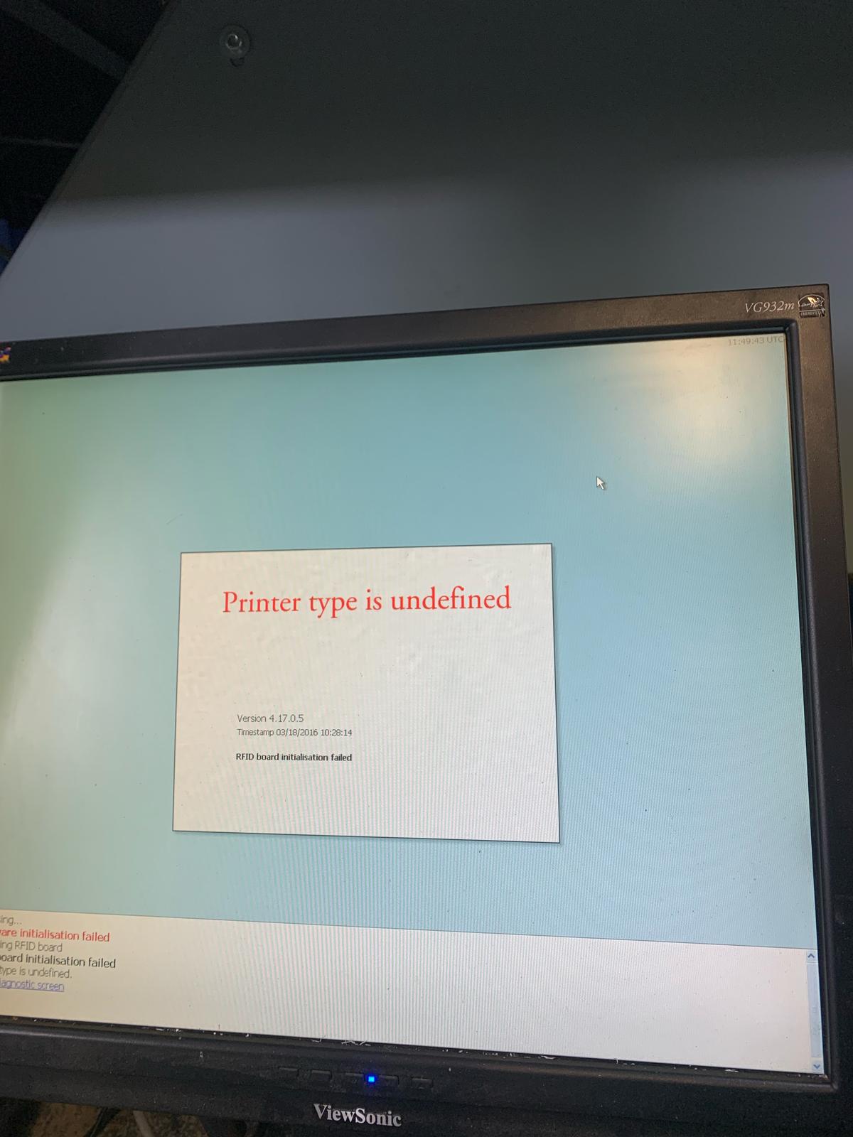

Printer type is undefined. RFID initialisation failed. If anyone had same problem can you tell us how to solve it please.

Seems to be a fujifilm aquity.
The rfid board is the one (or two, depending on model) close to the ink bag ports. Older units hat a serial connection, newer have a ethernet cable connected to the data relay pca. Check if power is supplied to rfid pca and if the connections are good.
