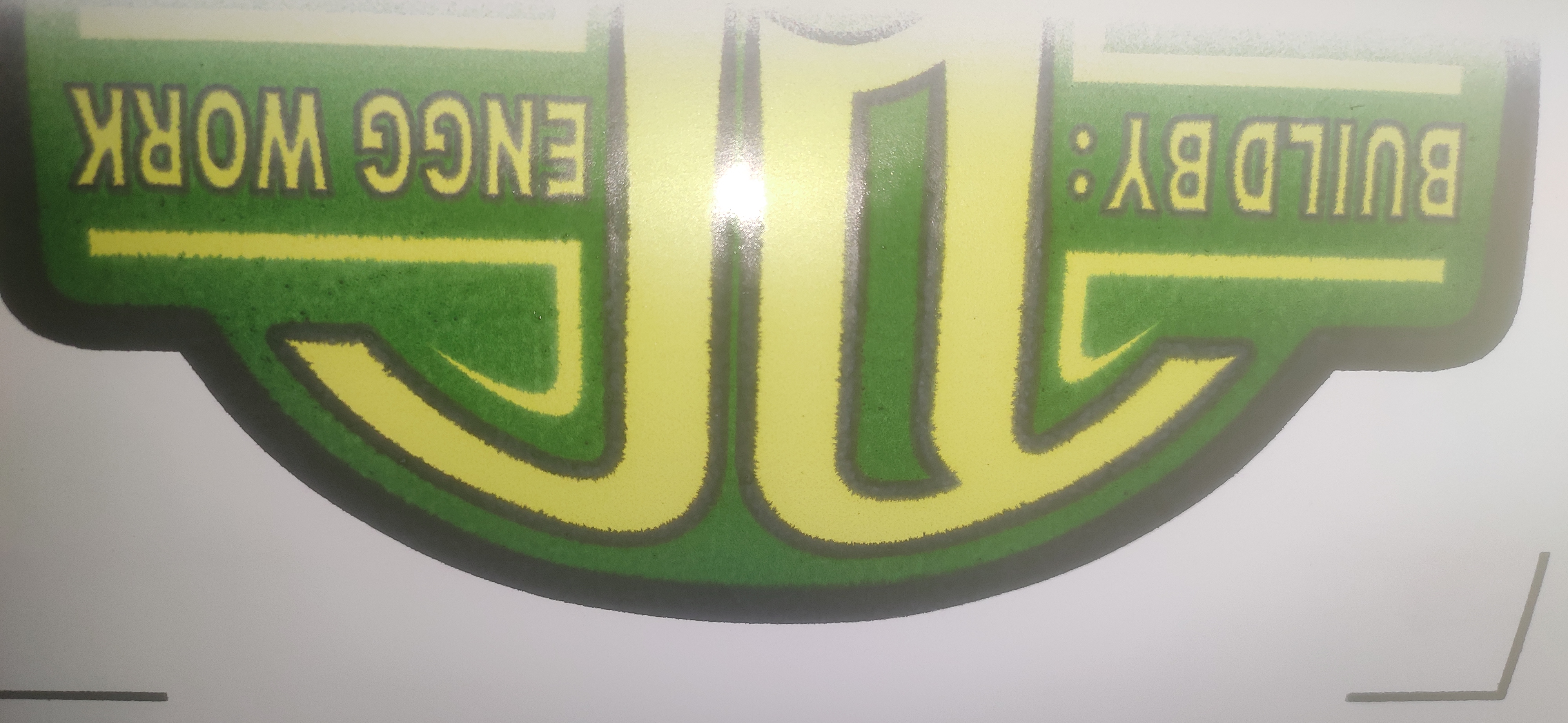

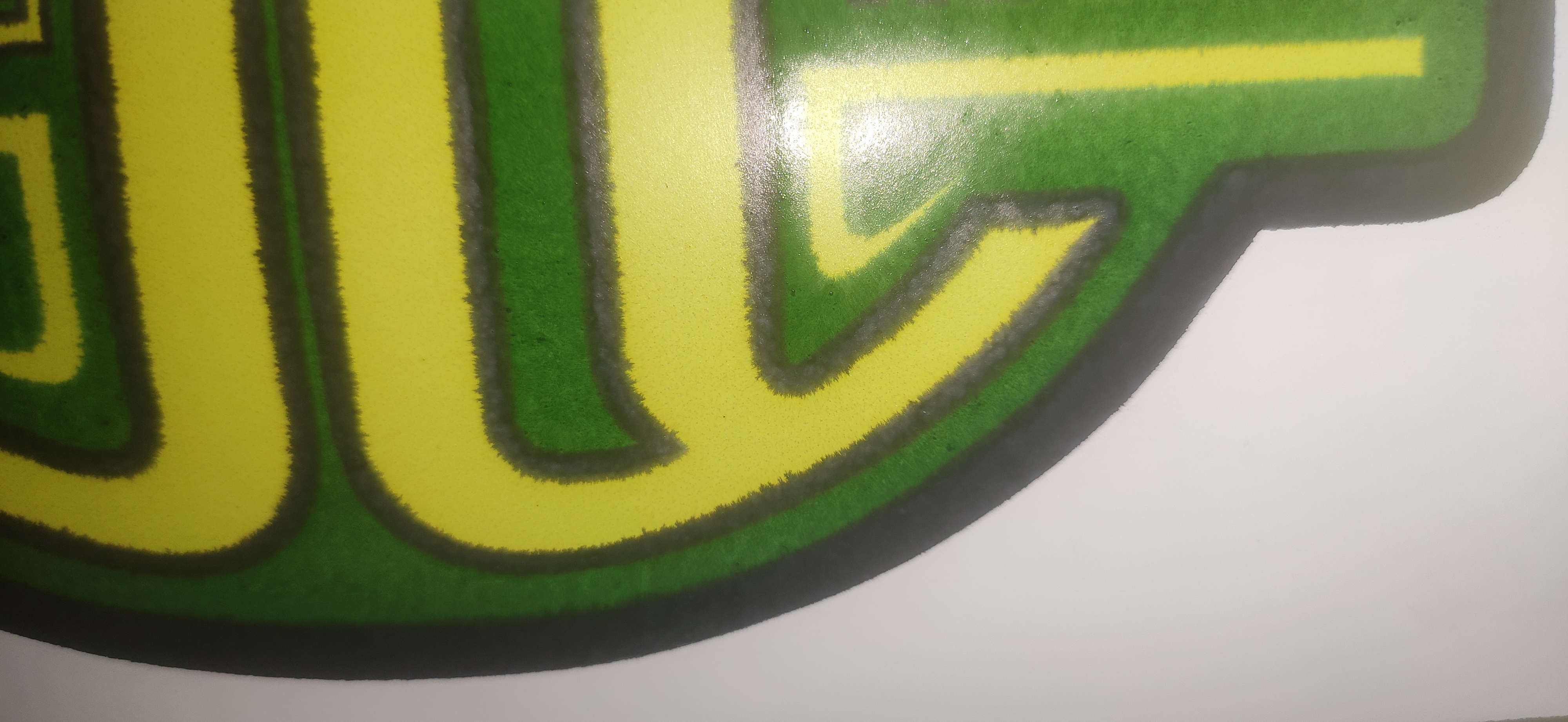

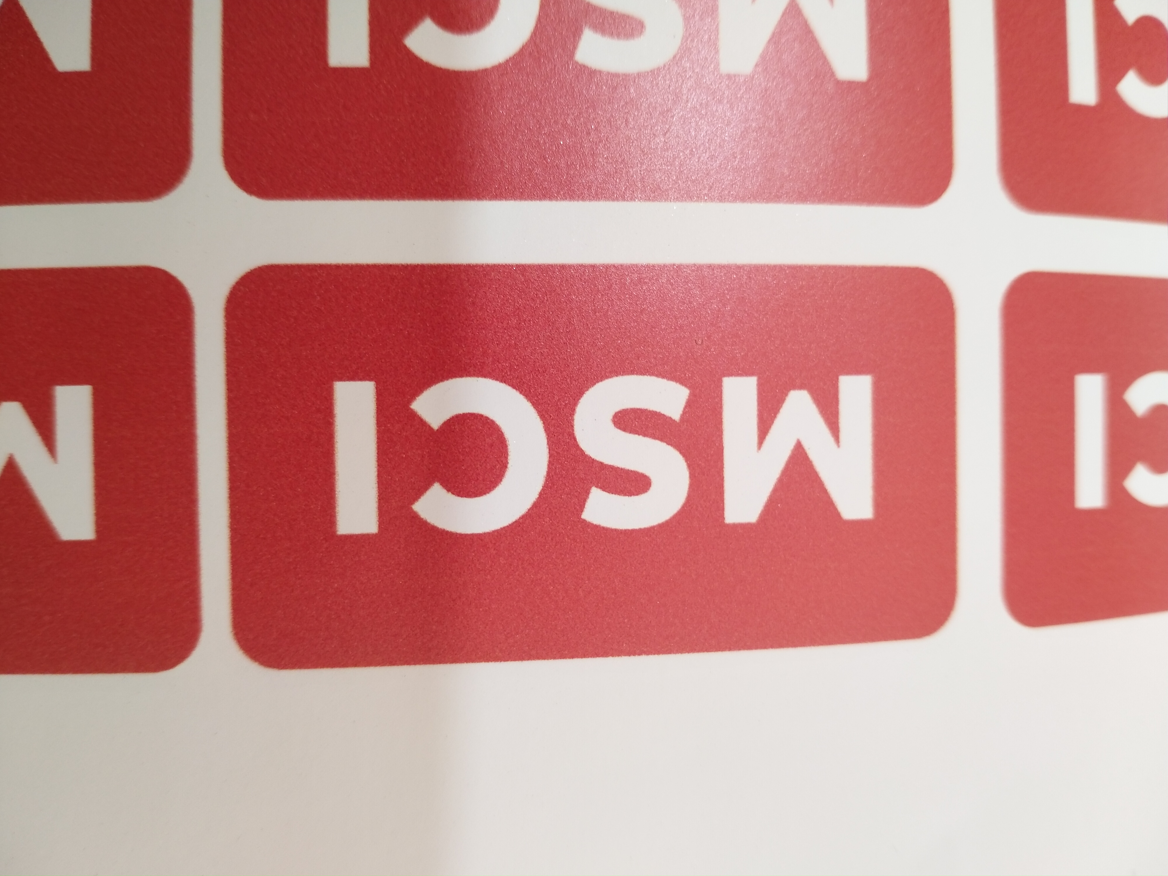

Hi, Just curious to know your work flow and if the grainy print image attached are normal bescause yesterday i went to a shop near me who owns epson s40670 and i brought my file as an .eps and they cant rip it (dont know what rip software they were using) so they import the file to photoshop and saved it as tiff which i think will effects the output and the print result is so grainy and the edges of the text are blurry or is it normal to be this grainy (image attached).

Not 100% sure, but that looks more like either a profile issue or the printer needs some alignment work.

I have found that when I had grainy prints with my old mimaki jv3 that it was my heat settings, either to much heat or not enough to let the ink flow a little. I agree with Zoogee world that it is a setting on your printer. I would try playing with the heat settings, i think its to hot and not flowing out. Worth a try. Please let us know if you figure out your problem.
MiguelGonzalez
Thank you, and in your experience what color code do you use for deep black that doesn't have red or blue tint . I tried C60%, M50%, Y50%, K100% output black is deep and rich but due to the intensity of the ink, when in contact with other colors, the ink formed unsmooth and wrinkeled edges.
