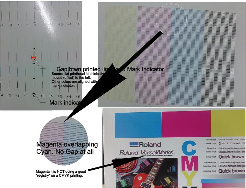

My Roland VP-300 is doing a "non-registration" printing. Looks like print head is
physically offset. Inks are flowing correctly but misaligned on just the Magenta
head.
Here's a set of pics with a more detailed explanation.
attachment.php
If you guys have any suggestion how to fix it. Please share it.

Have you tried head allignment?
JDcolor
when you face to printer, first head on left is reference.
You can align other printer heads depends on it.
Jack
lgroth
Definitely looks like it just needs alignment. If you need the service manual to assist with it PM me your email address and I'll get it to you.
cadware
Thank you all of you guys. I fixed already by myself.
I went thru the "special mode". Made the adjustments and I think
is fine. Made some print test and a final printing: Got Fixed.!
