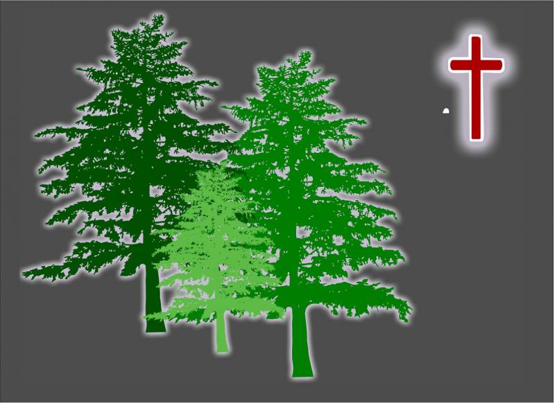

Here's the image with the "glow" (grey background is just to show it).
Thanks

I hope this isn't a dumb question but how do you create a vector halftone? Can you walk me through this?
