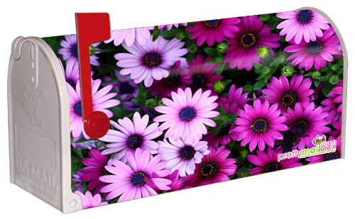

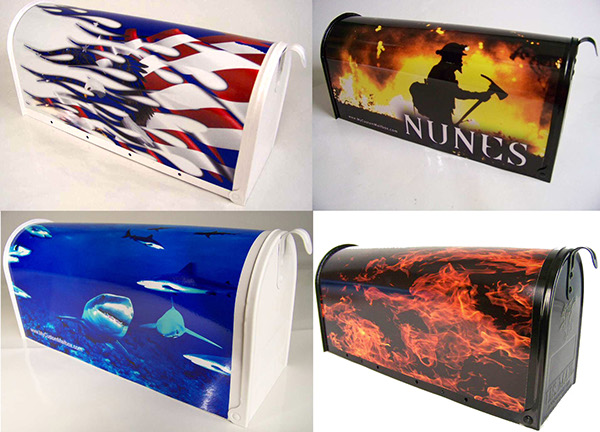

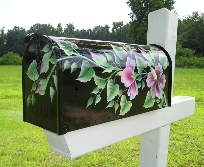

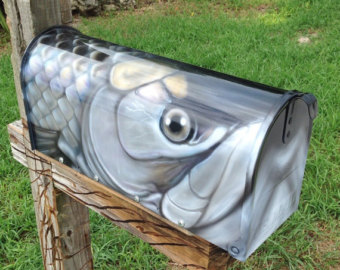

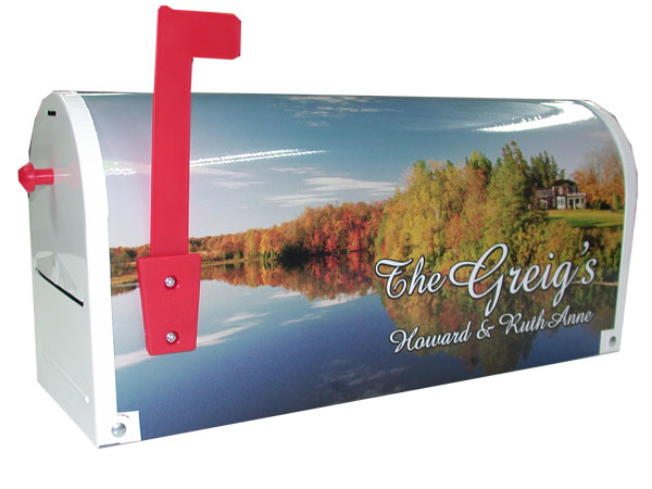

As others have mentioned printing mailbox numbers on clear vinyl is not really a good idea for all the reasons already mentioned.
However if you want expand your business and at the same time make your dream of having something new to play with became prosperous reality, you should consider thinking about making mailbox wraps. You could get the small Roland printer/cutter and a tabletop laminator with will be big enough to laminate the digitally printed vinyl from the Roland printer.
You could incorporate the mailbox numbers into the wrap (all one piece), and you could sell the wrap to your customers or offer to install the wrap for them which will increase your bottom line.
The other great advantage is the endless possibilities for the numbers themselves, using Photoshop filter you can make them look 3d and add drop drop shadow, this would be a big game changer for your business.
Here are some examples of the possibilities:
