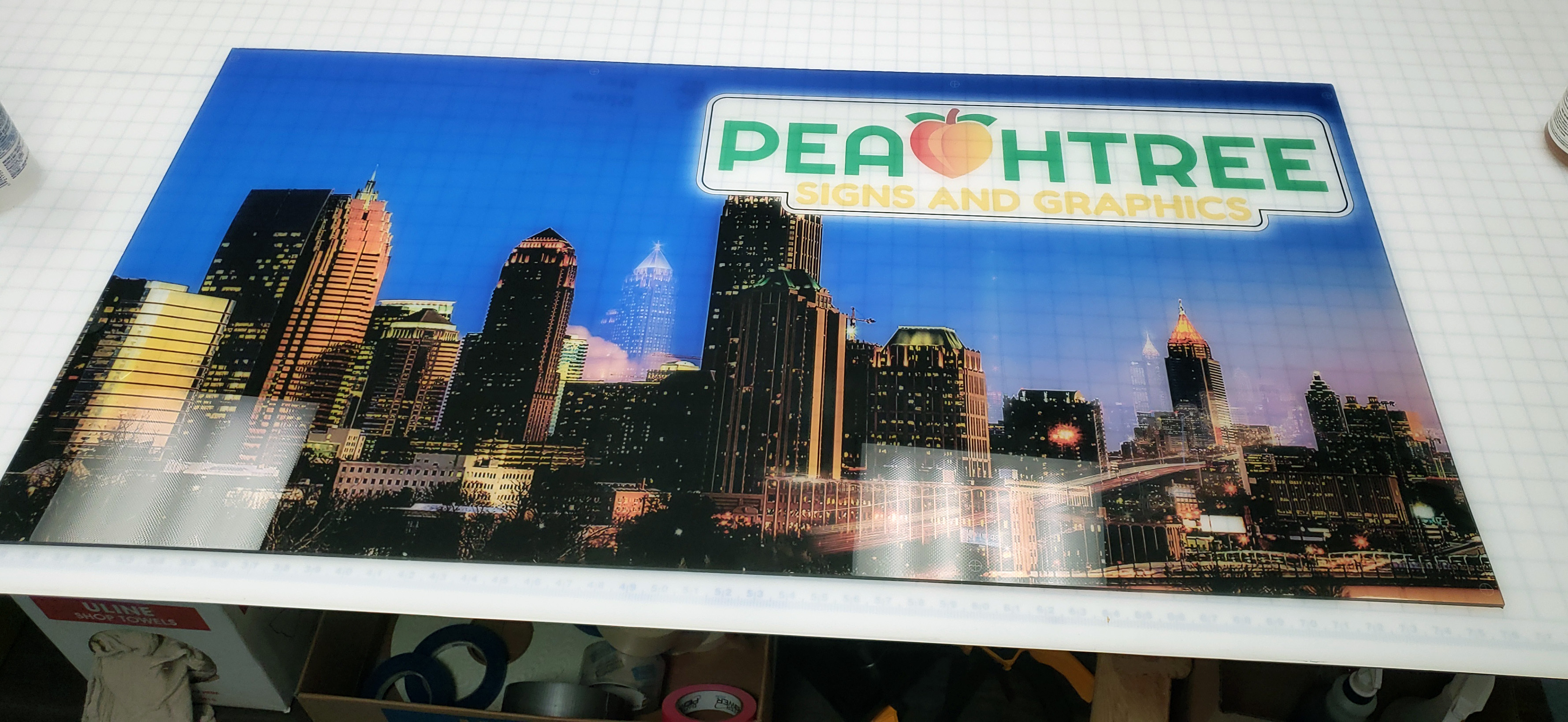

I did a search on here and didn't see anything about this so I thought I would share.

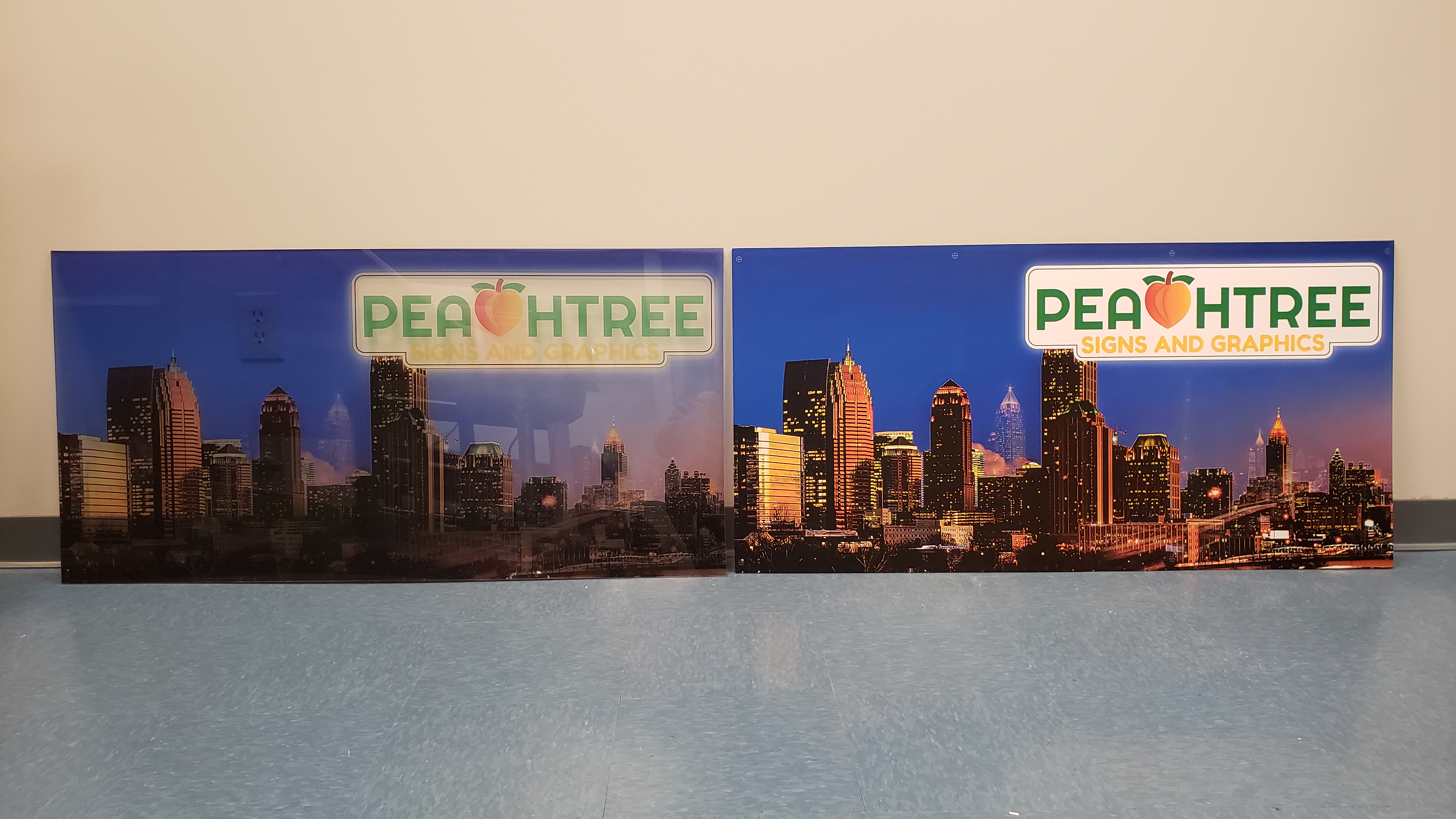

I wanted to do a reverse print of our logo, second surface, on clear acrylic so I did a quick design. We don't have any transparent vinyl so I thought about using some of the free Briteline laminate we got from the vendor and do a little experiment. The hardest part was getting the lam to cooperate with our HP Latex 365 printer but I managed to get a test print done using a profile from Kodak transparent film and it actually turned out ok with little adjustment. The print was easy to apply and I think it actually turned out pretty cool looking, mind you it looks better in person than in the pics. Also here's a comparison with a print on first surface.
