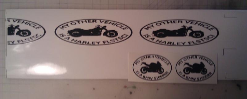

So last print of the day and this starts happening. For some reason it starts stretching my prints really wide and out of proportion. In the picture you can see the the decals at the bottom, that is what size the ones on the top are supposed to be. I looked to see if the proportion was off in Flexi, it wasnt. So then I thought maybe it was the driver. So I uninstalled my printer from flexi and reinstalled it. Still prints like that. Tried different files. Still prints like that. Very strange. Been printing fine all day. Of course its the last print of the day and right before the weekend! Anyone ever seen this or know whats causing it? Printer or software? I am running Flexi 8.6 on a Mutoh 1204. Thanks in advance!

Is that across the width, or the length? Encoder strip dirty? Is there a calibration you can do?

I think it is something at the printer end and not the RIP settings.
Even the crop marks in the photo are stretched in one direction.
I don't think you can do that in Flexi with a setting.
Maybe need to re-set the printer back to it's factory defaults if such a option exists.
Randy will know how.

It looks like like a resolution issue, can be when there is a mismatch between the printer and RIP.
Usually the RIP controls the printer, and you can change the resolution of the printer, but if for some reason the RIP is not set to override the printer, you can get things like this.
So check to insure that your RIP settings are correct.
And you can change your printer to match your RIP resolution.
Should be something like "Print Mode" on the Control Panel of the printer.
A reset to defaults is a bit more involved.
You need a tech to walk you through the first time.
You have to back up your "Parameters" with Mutoh Software before you reset and load them back in afterwards.
But this looks more like a setting somewhere.

Most likely a mismatch with the settings between RIP and the printer or a bug in the printer driver. If you believe the driver is OK, check that the print mode selected in the RIP is supported by the printer.

I will check when I get chance. As for print settings they were the same I have been using. Printed all day with the same settings. Ill keep you updated. Thanks guys

Somebody has been playing with the settings on the printer... On the road now but will post resolution when I get back to work next week... RandyA is right, you will need to download the parameters and and blow the firmware, then re-load... That is, unless you remember exactly what was changed and what the original value was... In any case, it would be wise to get the parameters and save them anyhow...

Thanks Randy! I checked "enable driver options" and now it is printing properly. The only settings I have done were yesterday when I set up each media type on the front panel of the printer. Should I not use the front panel and just adjust all settings through Flexi? I am new to this printer so I'm still learning how to use it. Thanks for all the fast responses though :thumb:
