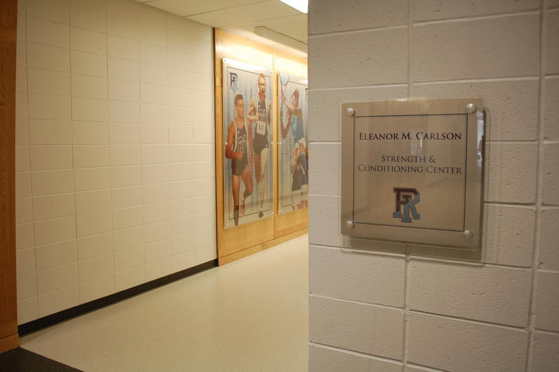

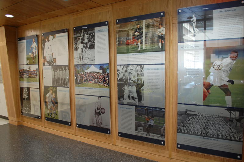

It really is a great high end look.. We have done these for some universities and other clients for recognition plaques with photos..
Using the substrate background and not using white is the way to go to get the effect.. Using white just makes it look like a normal piece of WHITE ACM panel and you lose the grain of the substrate ..
See attached pics.. We put 1/4" acrylic over these for protection per architect spec, but you get the idea..
They were printed on an EFI machine.. Many UV flatbeds would yield this effect to my knowledge.. No white ink was used..

The boards in he first picture have white all over them.

Oh they do? I must have hit the print on the non existent white option when printing, and the client must have not approved them when we delivered them, and I must not have given them a hard proof to show them the
difference.
Silly me, I must have not made these myself..
It is amazing what a cmyk printer will do these days.. I must have had some magic fairy dust floating around the shop that day..

Must be the picture then. Because the black guys shirt looks a lot whiter then the box of text to the left of him.

What color is the substrate? It just looks like a print on white gator. All the whites without white ink appear Silver to me and the guy would be pretty much the silver surfer playing soccer when I print them on aluminum without white ink.

Brushed aluminum ACM panel, vertical grain.

There is no white on the print, it is printed on brushed aluminum .. cmyk...
