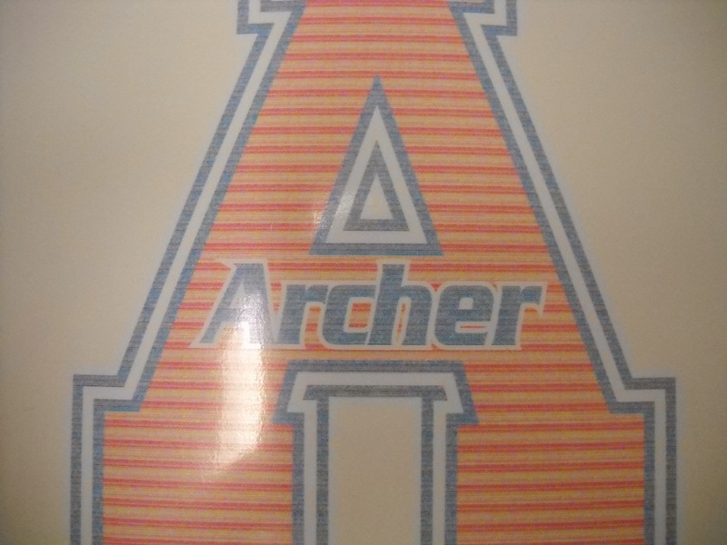

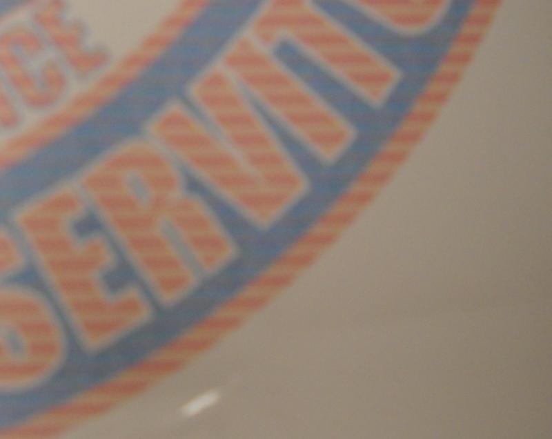

I'm having a problem printing on my 1204. It printed fine yesterday. I went to print today and it is not printing right. I can see bands and the colors are not right. The reds look like pink and the grey looks blue. I've attached a couple of photos that may help. Any help would be appreciated.

I did the nozzle test and it shows that the nozzles are clogged. I'm in the process of dong a cleaning to see it helps. They recommend putting a saturated lint free cloth over the capping pad for 30 minutes. Is this the best thing to do?

looks like you may have left the head un-capped over night... Soaking the nozzles should do the trick...
or
the seal on the captop has some debris or dried ink on it letting air in while capped...
