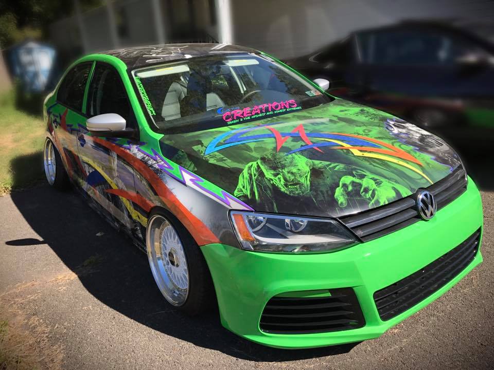

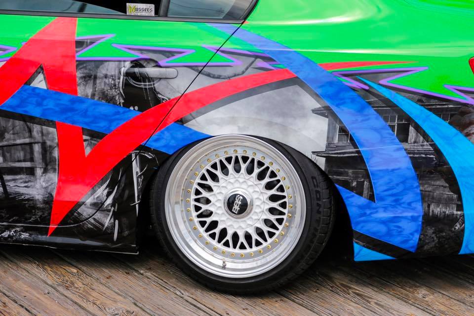

printed with the Hp 370 now we use the HP 570 best color ever!!!!!!
the car was silver
