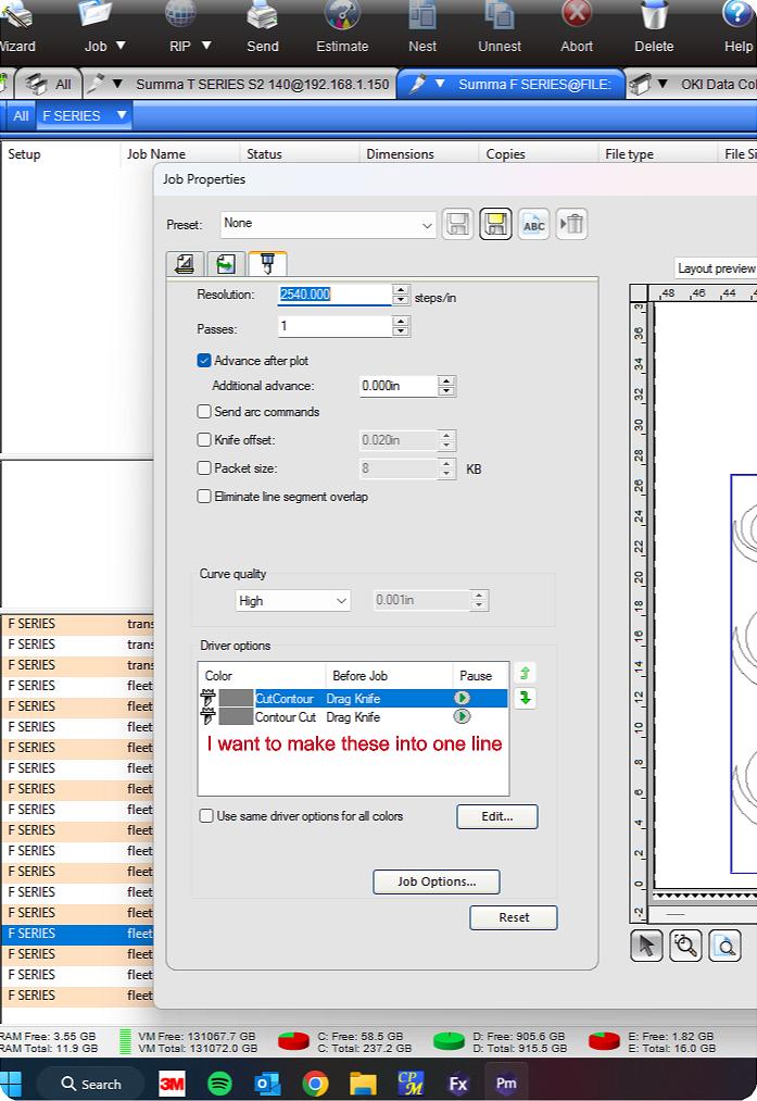

So im just wondering if anyone knows a way of merging two contour cuts on production manager.
For some reason my file will split it up into 2 line items and then only cut one of the 2. The machine is set up to cut both but will just cut one or the other.
I attached a photo to show what I mean by the two line items.

It looks like you're using two different spot colors in one file. Make sure the lines in the design file are actually named the same spot color.
