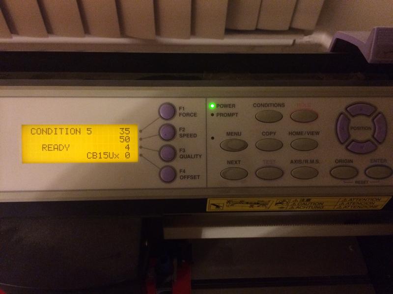

Is this machine that is based on the Graphtec FC8000 / FC8600, or on an earlier model, such as FC7000? With the FC8000 Graphtec changed the control panel considerably from what they used previously. If you're not sure, you can post a photo of the control panel...
Sign Warehouse has re branded Graphtec plotters for many years, so the model Q100 could be an OEM of any number of Graphtec machines.
NazGraphics
posted a pic of the control panel
thanks for your time

That is the 'older style' control panel that Graphtec used through the FC7000 series machines, but changed with the 8000s and newer models. Unfortunately, I cannot recall the layout of the menu system on those units, but the same functionality to use the plotter's settings versus software control is available.
