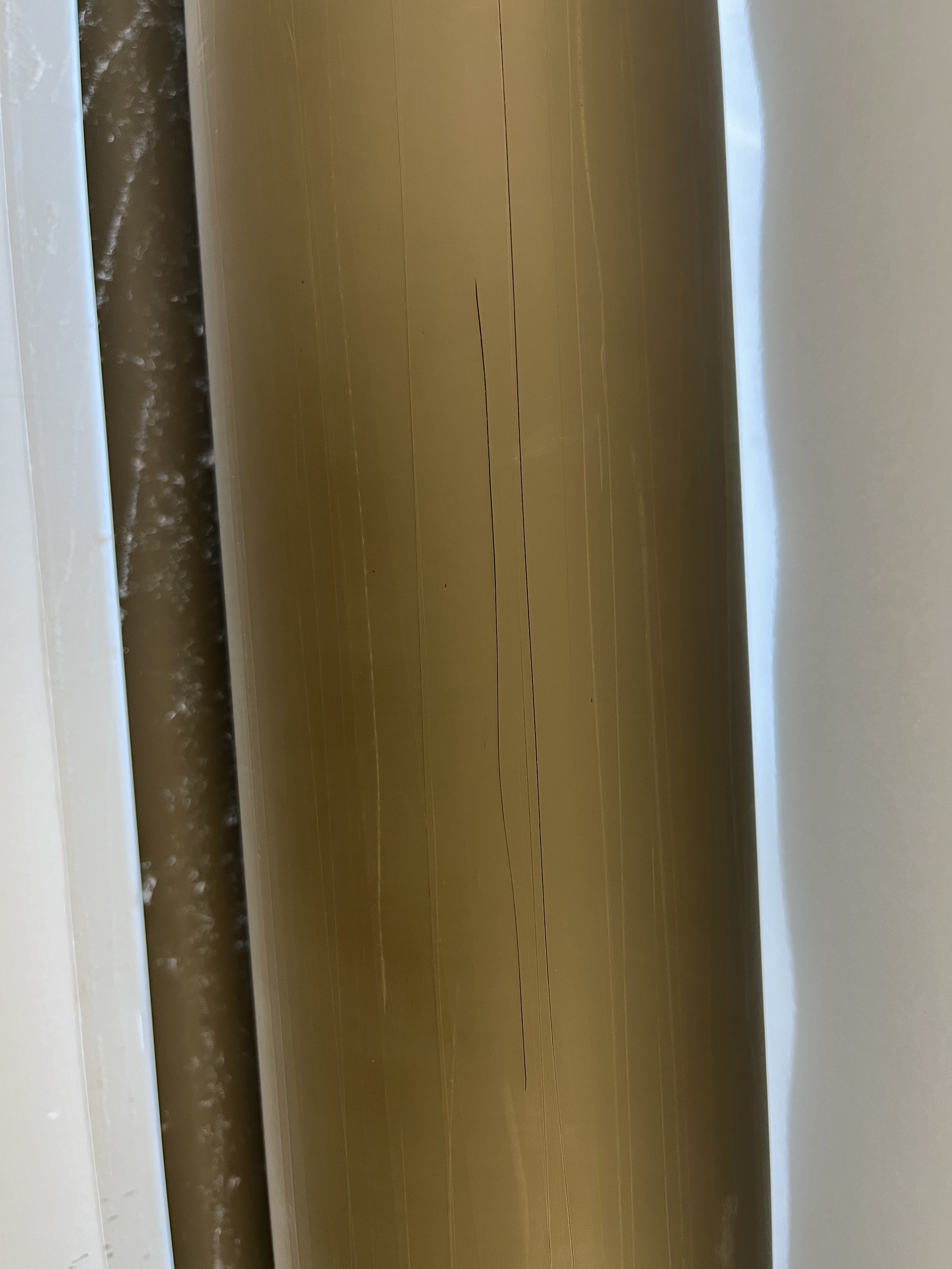

Hi,
I have a Qomolangma FMJ-1600-WA-PLUS. We had this laminator back in December 2023. We ordered it off Amazon. It seems as though all of our employees have made scratches and dents from using box cutter blades. Unfortunately, these cuts are causing bubbles in our laminating. We didn't know that we were not supposed to use box cutters, knives, or any sharp objects on the top roller to remove the excess lamination as it states in the cleaning section of User's Manual. Amazon does not have a roller replacement on the Qomolangma FMJ-1600-WA-PLUS. However, the only place I could find somewhere who would have a top roller for the Qomolangma FMJ-1600-WA-PLUS would be Sign-In-Global. I understand the laminator is from China and if there is not a way to replace the top roller, then we just wasted $3k for employee negligence. Is there a way to replace the top roller or cover the cut marks with something that will fix it perfect?

I do understand that! The top roller of the laminator is fragile enough to cause permanent damage. We are one of many companies who used our laminator like this. Unfortunately, it was the wrong way to cut the laminate off.

I just got a response from Sign-In-Global. They do offer replacement rollers. Which is good news!
