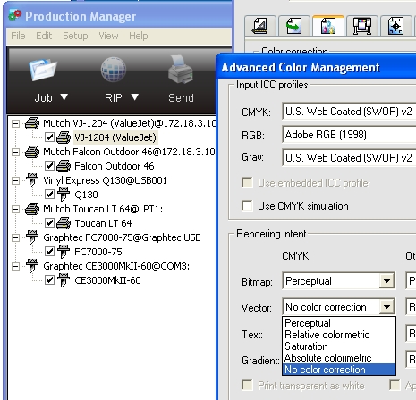

If you want PURE RED, double click on the red in the swatch table. Now change the color management rendering intent to SPOT and save. Rockin red....
Compilla
Welcome Mark!!
What if using Flexi 8.5 ? Spot Color it is not an option on the rendering intents....
mrugen
Reds
Sure it is IF you double click on the swatch table color. Double click on the red in the swatch table, then look to the right whre you'll see color management, change the rendering intent to spot.
It is NOT part of the output system anymore for some reason.
Compilla
Not in there Mark...

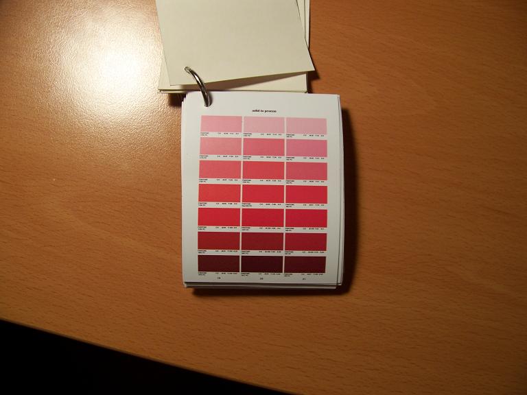

D&Tgraphics
Try using a pantone color pallete. Pick a bunch of reds and make little squares in a file and fill them with different reds. Now print them and see which one looks best. Use that as your default red.
Valentino
Pantone 1797 PC
C: 0
M: 100
Y: 99
K: 4
as proof...the swatch book was printed on our VJ 1204, at graphics 2 on 3951 matte. It's a really rich blood red. pantone 711 is good too. (4th row down, middle column)
