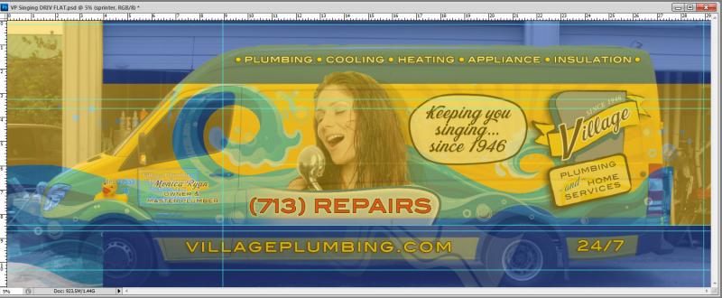

We design elements for a wrap in Illustrator, Corel or Photoshop... but the final wrap design is always done in Photoshop on photo templates that we create. We never use vector templates. Our files are set up at 1000dpi at 1/10 scale and printed at 1000%. For some reason, in my experience, Photoshop understands 10 inches at 1000dpi better than it does 100 inches at 100 dpi. So, essentially we design at 100dpi. Sure, 72 would be sufficient for most things, but 100 just makes the math so much easier when you are scaling things up.

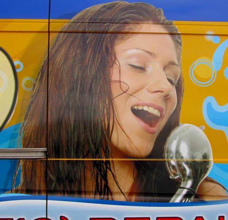

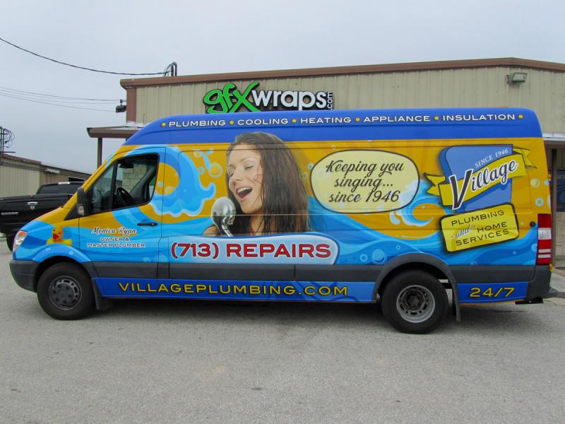

Here's a screen shot of a production file and the final product. We do it this way every time. The only thing is doesn't work well on is boats and big trailers, Rv's, etc. We usually draw guides on the photos so we can see the actual measurements while still looking at the real life obstacle of the photo. The photo method also doesn't work on really curvy vehicles like VW bugs. You have to pull paper patterns for that and make your own templates.
Once your layer file is finished and approved, flatten the art layers and crop up your own panels for the best possible install. These Sprinters are impossible to do seamless, but we don't panel them like wallpaper either. That would be ugly. There's one horizontal seam running above eye level. The rest is seamless.
