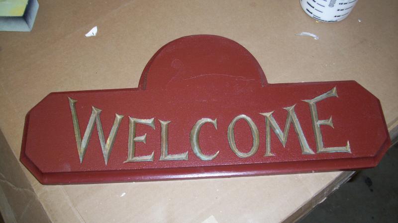

Thanks for the replies everyone. A photo of the sign is attached.
We suggested repainting everything, but the customer was adamant he liked the old gold lettering and wanted to freshen up the surrounding red areas with a paint to match the trim on his home. This has since been lightly rolled, and even with our additive, the paint is a little too textured for my liking.
I think I will look into this Friskit product....
- Keith

Lettering enamel with a retarder such as Penetrol applied with a rubber brayer will do it properly. If you are careful about applying it, you will bridge over the incised letters.
No brayer? Use lettering quills.
S'N'S
Just had a thought, I wonder if you could use plastersine (kids stuff) and push it in there, would come out easy enough.
That sign needs a really good sand, you can see the outline of the swan.

I say it was antique because he bought it from an antique shop. For $15. He is rather attached to it.
He supplied his exterior latex paint for us to use. We made it clear up front we'd do our best and couldn't guarantee the paint, although it appeared to be a decent sherwin williams line.
(The swan outline was the original unpainted area where a wooden duck that was on the sign will be reattached)

I'd gild the letters.
That thing is really rough looking.
Gild, outline with black, make the border black. Gild the swan too but first paint a black circular shape behind it or even do a water pictorial.
If he thinks that looks good as is he'll tinkle in his pants if he sees it tarted up.
Aside of the fact, that it's butt ugly.... are you gonna still paint in the swan ?? I wouldn't waste any gold leaf or time on that. Just roll a few dry coats on the background and buy some gold paint and touch-up where necessary.
Also, that is no antique. Looks worth about $75. total..... and that's finished.
SignManiac
Man Gino, you took the words right out of my mouth. Slop the paint on, brush marks and all. Besides that will make it more antiquey looking. And I would never waste gold leaf on that sign.
