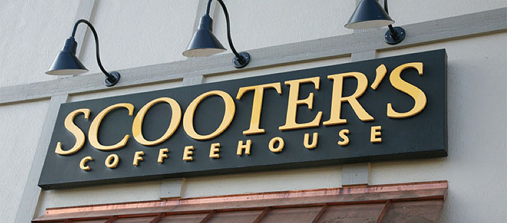

Question, What are the back panel boxes usually made out of?
0igo
Also are they made from a single sheet? because i never see visible screws on the sides of them.
If there is a supplier that sells them in northern california, can i get a link or number please. thank you. (its for an indoor sign and just the back panel not the channel letters)

That is probably just 2" aluminum square tube mitered on the corners and welded with a sheet of ACM with Lords or VHB's on, it could also be aluminum angle as well, but it could also just be aluminum sheet broke into a pan box. There is a few ways to do it
