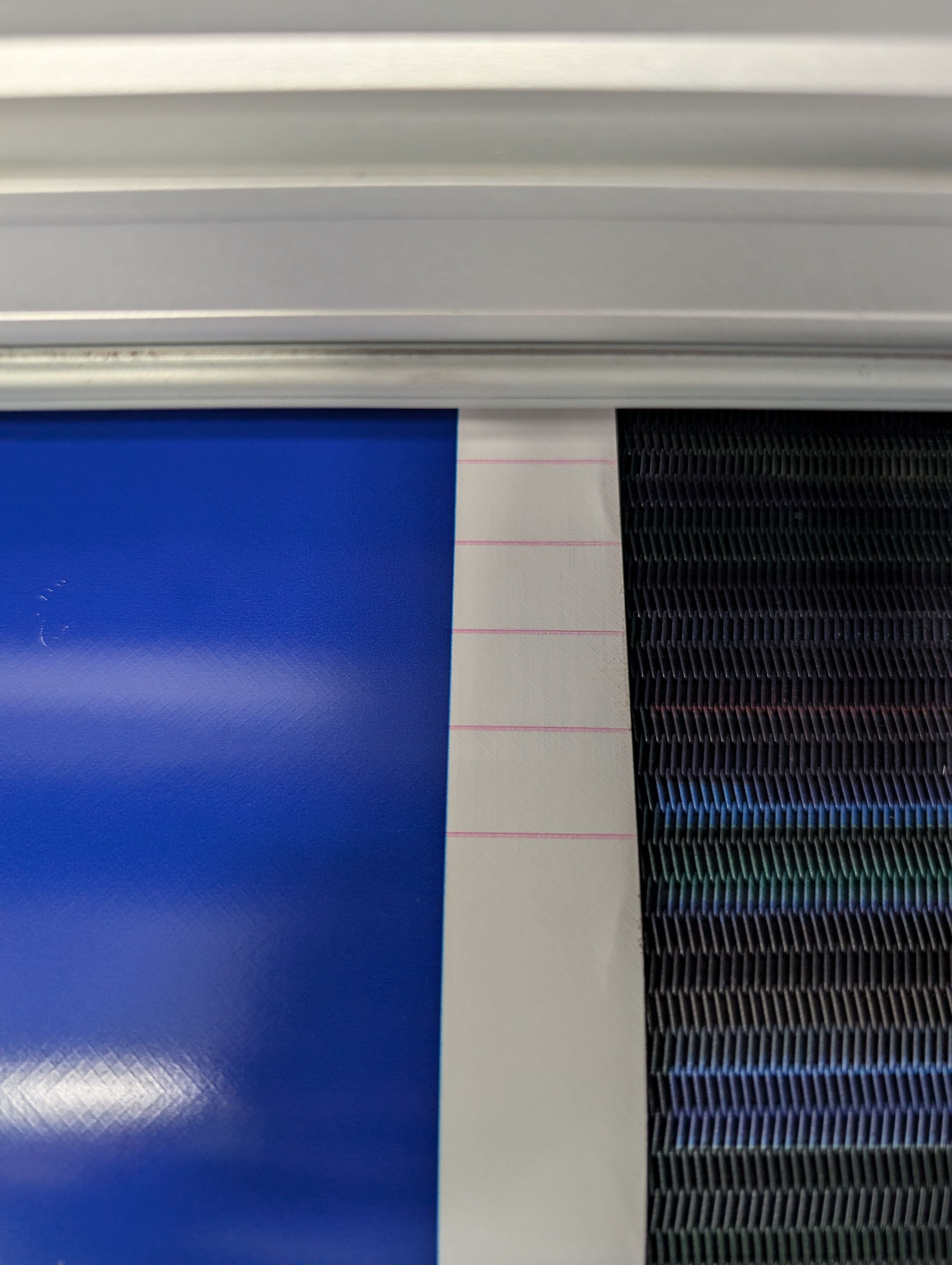

Anyone know why my R200 is doing this? Just recently aligned and verified. Encoder strip problem maybe?

Check and clean contact of interconnect pca.
Replace the printhead.
Swap interconnect pca with a different color and verify if problem is moving with the pca.
