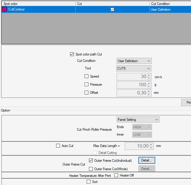

Hi,
With rasterlink 7 & 6 i want to make Outer Frame Cut (individual) after the CutContour (spot Color)
my CutContour use a Tool CUT5 (user definition) and my Outer Frame Cut (individual) use CUT6 (user definition too)
i printing stickers with rectangular shape with a lot of cutcontour inside , it's why i want to make all the individual Outer Frame Cut to be done after CutContour for all stickers
and all is 1 time without disabling the CutContour for the spot color and enabled the Outer Frame Cut
i have tested with the sort (enable / disabled) but it's change just the way the cutcontour is done.
Do you have an idee to allow this ?
Ps: individual Outer Frame Cut work on rasterlink 6 but not on rasterlink 7 with user definintion)

sbouey
I'm not sure to have understand everything , it's work or not ? or it's work only for the first one ? do you have screen capture of your configuration ? rasterlink 6 or 7 ? do you use Outer Frame Cut individual or a spot color CutContourHalf
- rasterlink 6 set with a Cutcontour CUT1 and Outer Frame Cut individual with a CUT2 work but , the Outer Frame Cut is not executed after all Cutcontour changing the sort only change the way the CutContour are done
- rasterlink 7 set with a Cutcontour CUT1 and Outer Frame Cut individual with a CUT2 don't work only CUT1 is used. (i haven't tested yet with the last RasterLink 7)
