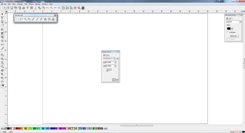

Select your image then in the 'design central' interface, type "25%" for either dimension and hit enter...make sure 'proportional' is checked.

Design Central in the center of the screen. Sounds like what you did may work, and yah I would hope if he requested it at 25% that he would re-scale it before printing. I'm assuming you guys already discussed the final size.
Also, check out www.wetransfer.com you just upload your file(s) type in the e-mail of the recipient, super easy and free up to 2GB. No more worrying about file size in e-mails.
