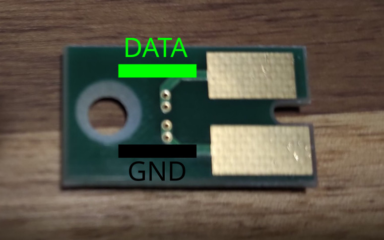

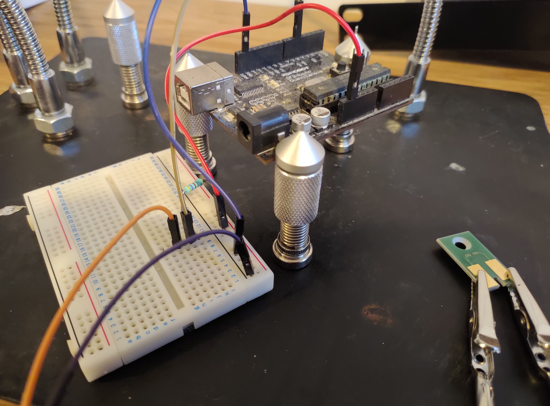

Taking the chip out I saw an EEPROM chip, and looked to read the data off it.

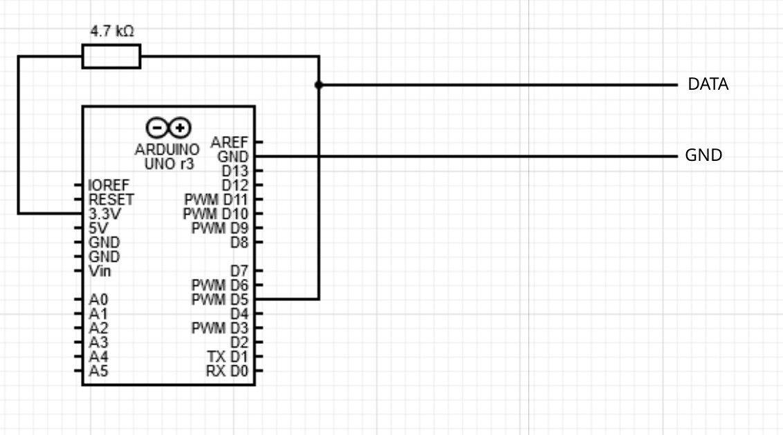

Its uses the DS2431 which has a great Arduino library. https://docs.arduino.cc/libraries/ds2431/
Wiring diagrams are attached.
I used the example sketch (removing the write functions) to read out 128bytes although it only uses 32.
