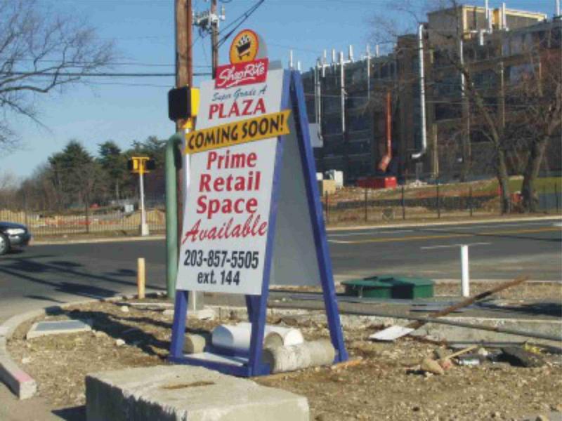

I've done these as a giant A frame.
Once set up on site, screw a couple 2x4s ties on the bottom, and put some sand bags on these.
I found a pic of one we did on site when we couldn't get holes dug. We added some plywood and
used some concrete tubes that were at the site to hold it.

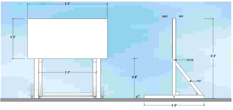

Pat Whatley
it would be tough to tip this skid over...
Actually it would only require a 22.3333 MPH wind directly on the face. You've only got 3' of support on each side to support an 8' tall sign.
We'd build a stand like you've shown but we would anchor it into the asphalt with L brackets and tapcons. There's another shop in town that drills 3/4" holes through the asphalt and pounds in 18" rebar that is bent to have a hook on one end. The hook fits over the base to hold it in place. I've seen their posts break before the base comes up. Haven't seen how they get them out of the ground when they're done though.

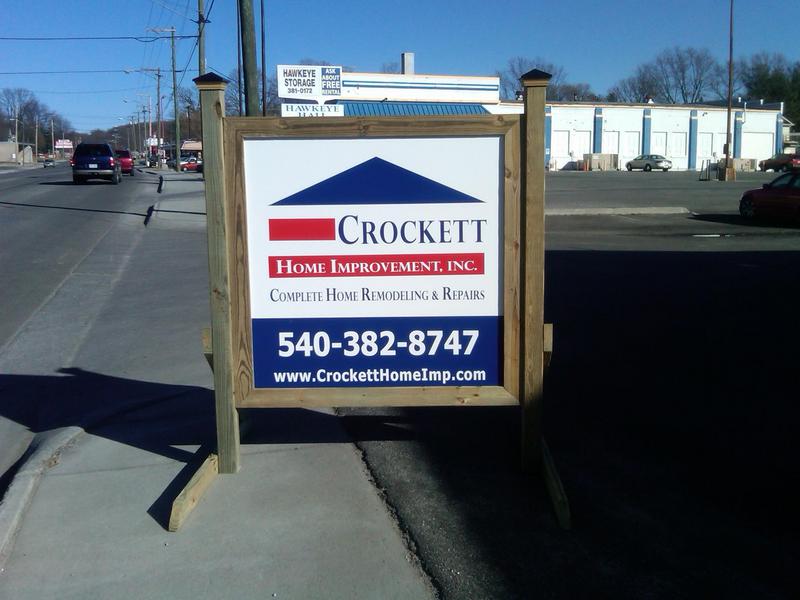

Here is one we did for a client...
ACM panels and wooden post frame system. Worked fine and our client can now display this sign when digging is not an option.
