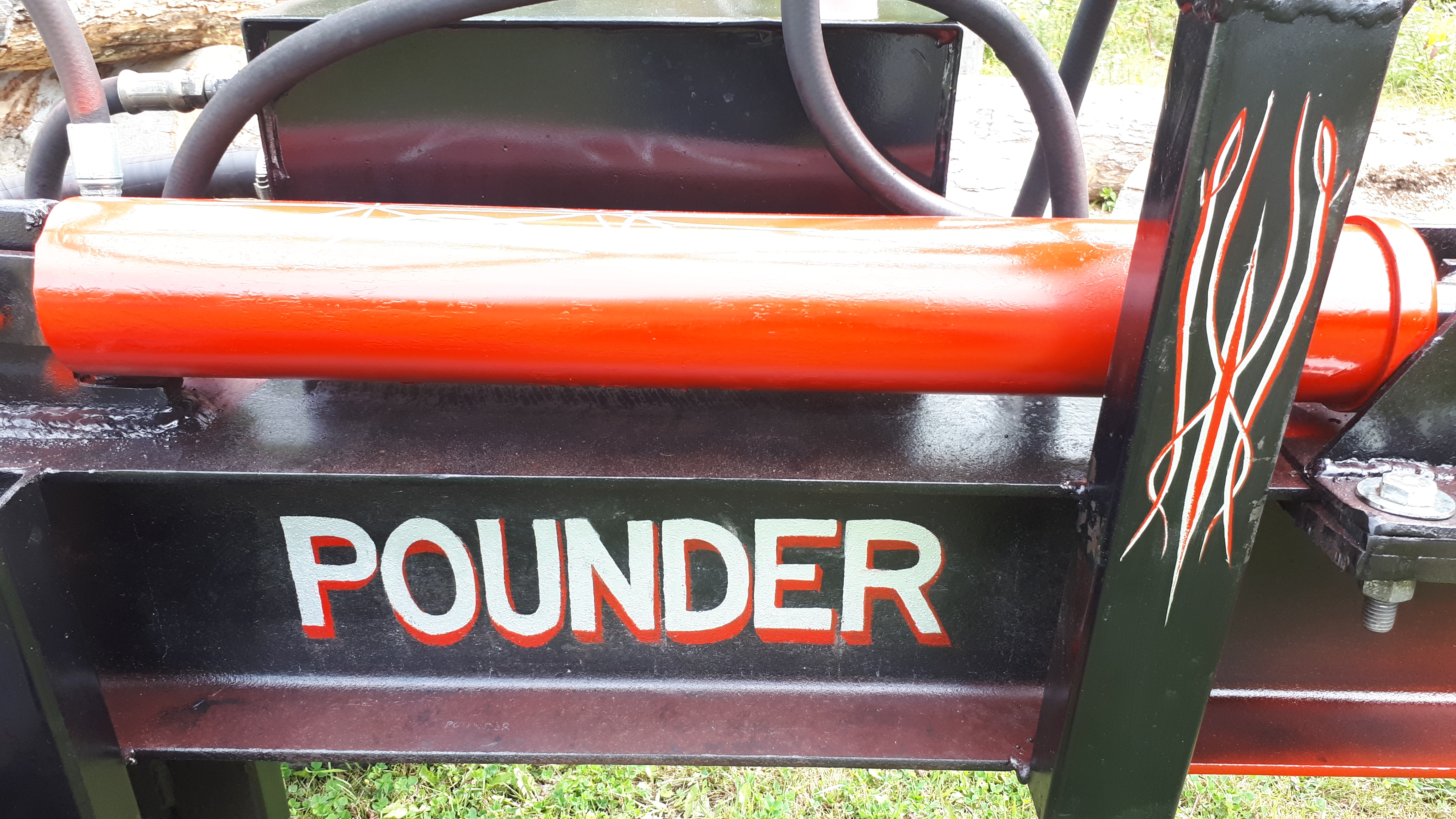

Ok, so here's my act of bravery for the day (year!) Loading up pics for you pros to view - phew! (For the Brene Brown fans)

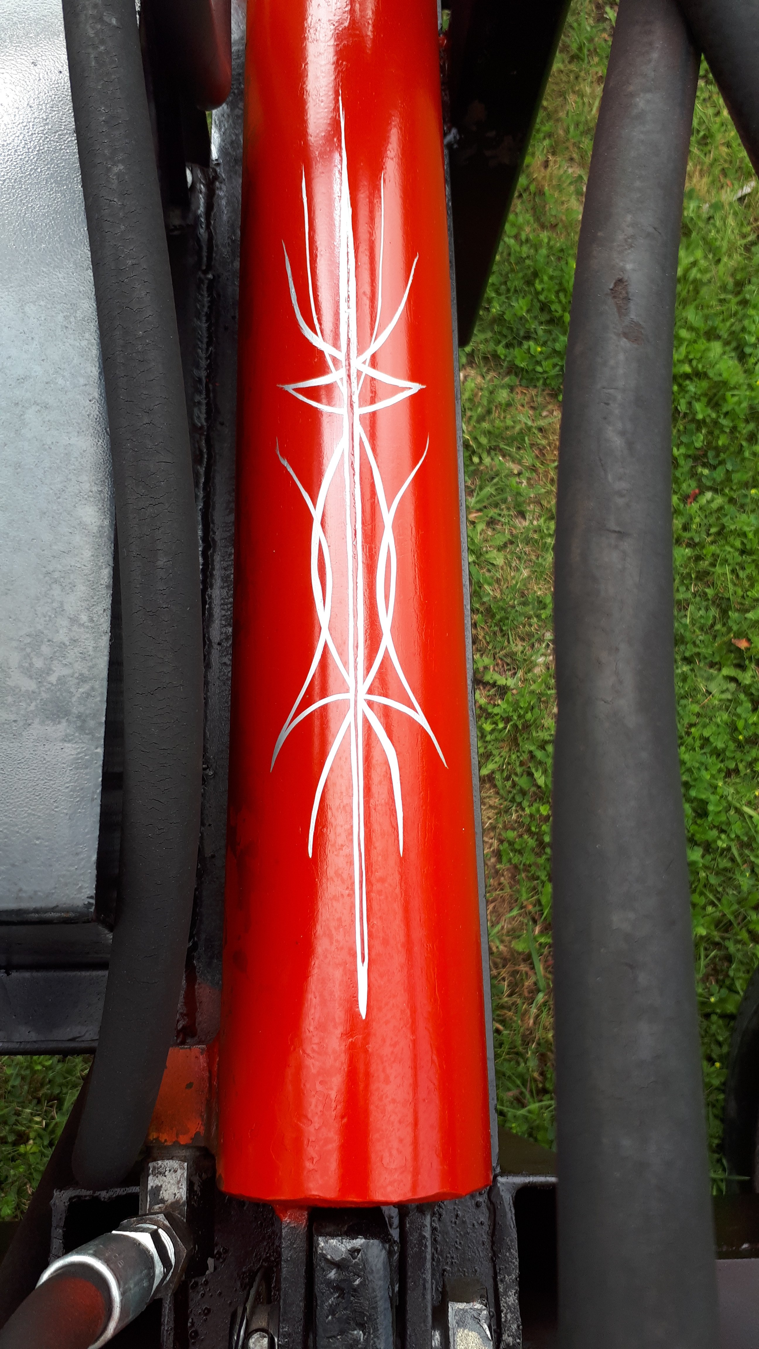

Pic 1 is only part of our wood splitter I striped last week as a practice project.. sadly, the main image fails to load - will keep trying...

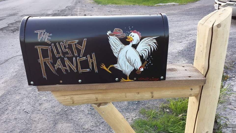

Did this mailbox several years ago. Sickeningly, some one ripped it right off its post 3 days after I gave this to the owner.

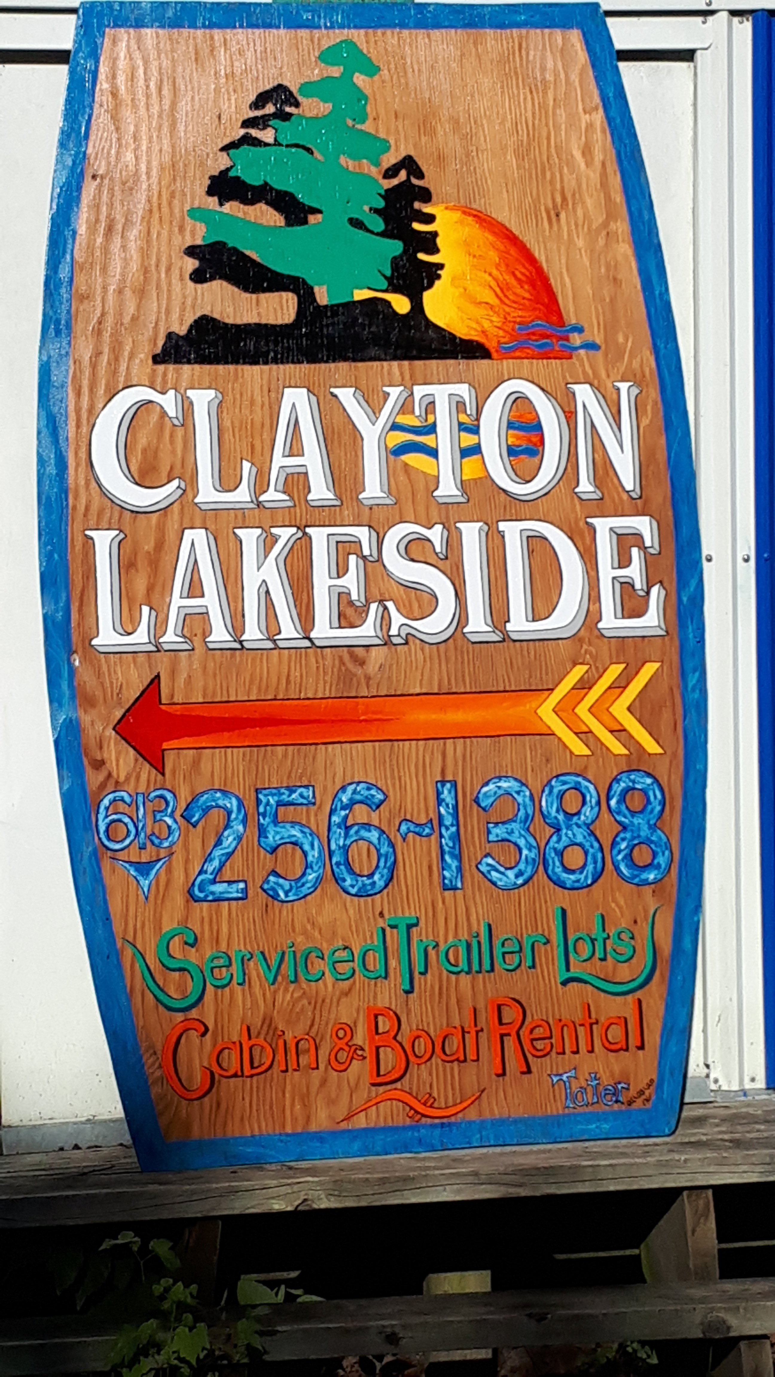

The above sign was a commission for an RV park. The (uneven) board was later mounted to a post.

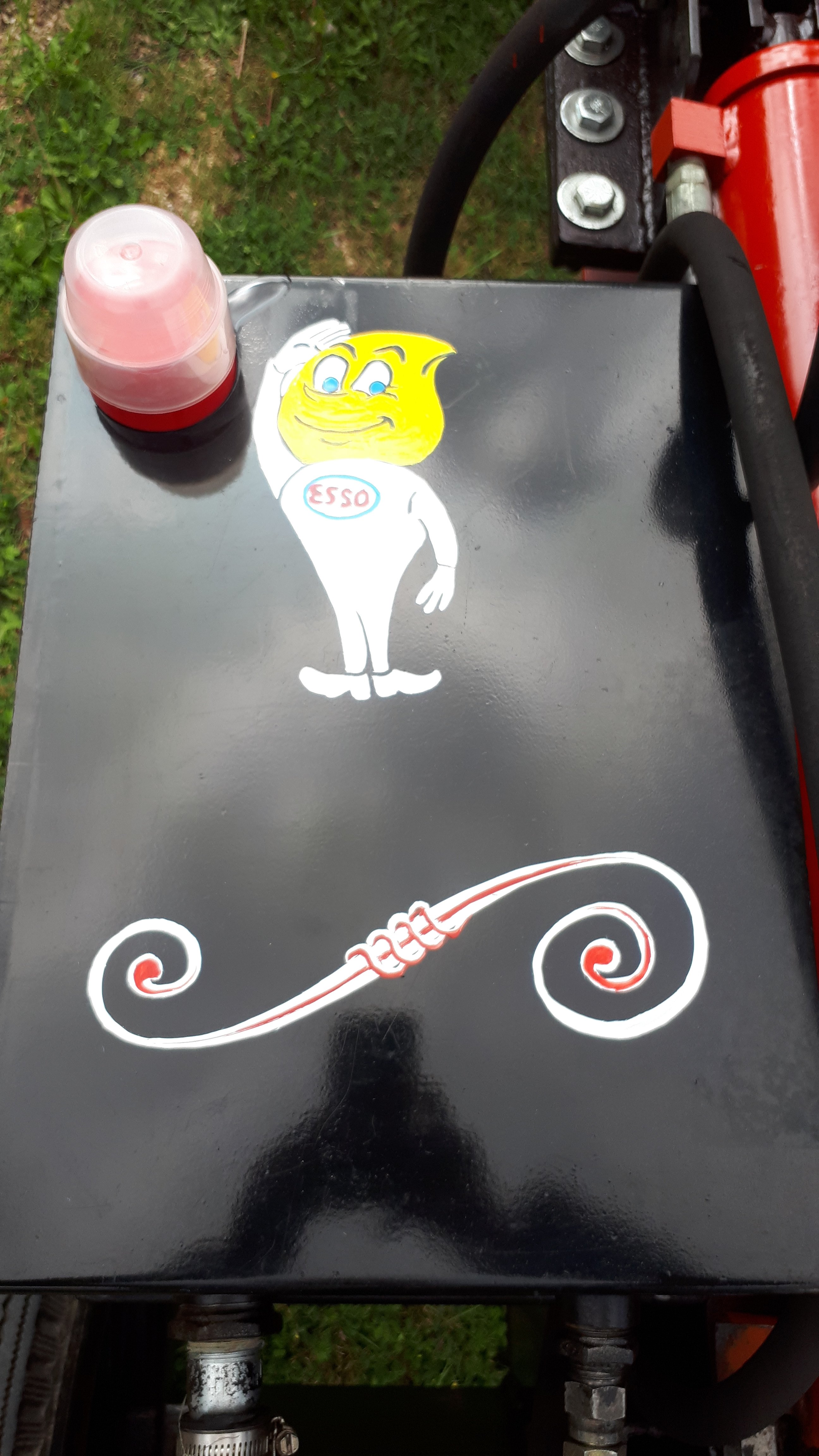

So, yet unable to upload the full pic, here is the hydraulic oil reservoir on our splitter. I treated the entire project as a "Speed" challenge. I also took the opportunity to test drive Rustoleum (in a pot) to see the longevity of a cheaper than One Shot option for outdoor equipment applications...
*Esso Oil drop done in 1Shot
Alas! Meet Pounder, our powerhouse wood splitter.... again, this was a speed challenge... I shot a phase red into black across the whole splitter and taped off critical hardware to keep the metallic effect of the controls...

Pinstriping and vehicle graphic by John Hannukaine put out by Signcraft technical series is pretty good they will have other book also, if they still have them. You need a few alphabets to get down well. I don't think you are reducing your paint correctly. You can buy some acrylic lettering brushes and practice on paper to wotk out your flow and brush handling.. You also need to use a bridge either you own wrist or arm or a mahl stick. His book will show you how to trim your sword brushes. I hope you can fine good brushes still. From what you have shown us you need more practice.There are good Youtube videos out there that will help you. Remember to not hold your breath and look down the road a bit like driving.. Things like where you grab your brush will shorten and lengthen your stroke. Working with your fingers or adding in your wrist forearm to your whole body sets up the many body mechanics which will allow you to make different sizes and types of line. Try to fine someone close to teach you some in the end you will figure it out. Good luck.

- re alphabets Alas, my local mentor "ghosted" me just as she was planning on teaching me the art of lettering. You are bang-on, I do need TONNES of practice, not to mention coaching/direction re brush control and to be sure, reducing paint properly.... argh! As a "Recovering Perfectionist" I indeed DO STRUGGLE to loosen up and relax.... but totally get your driving reference (having been a pro driver most of my working life...) so that is also helpful to be sure... this is why I throw "mini-challenges" like free-hand, speed or accuracy into my practice projects... hard without a bit of structure, but I am my own instructor, so I try to push myself past my comfort zones (which are currently RARE) in this art.... I am still at that stage where I feel an odd unease/exhilaration leading up to and throughout each new piece... maybe that will always be with me?
As for the mahl stick, yes, I used my newly acquired one for the first time when I did the Clayton Lake sign... it's a whole new world working with it!
