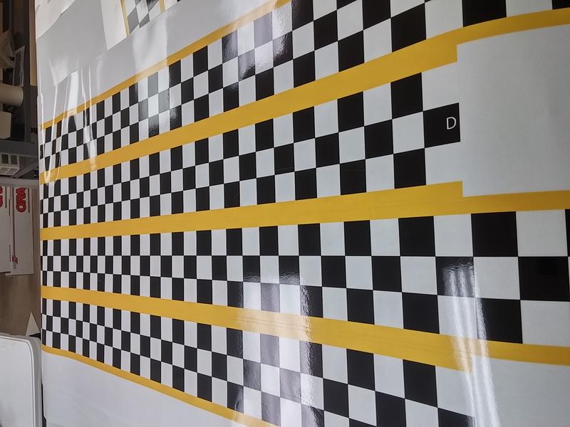

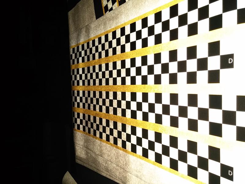

chartle

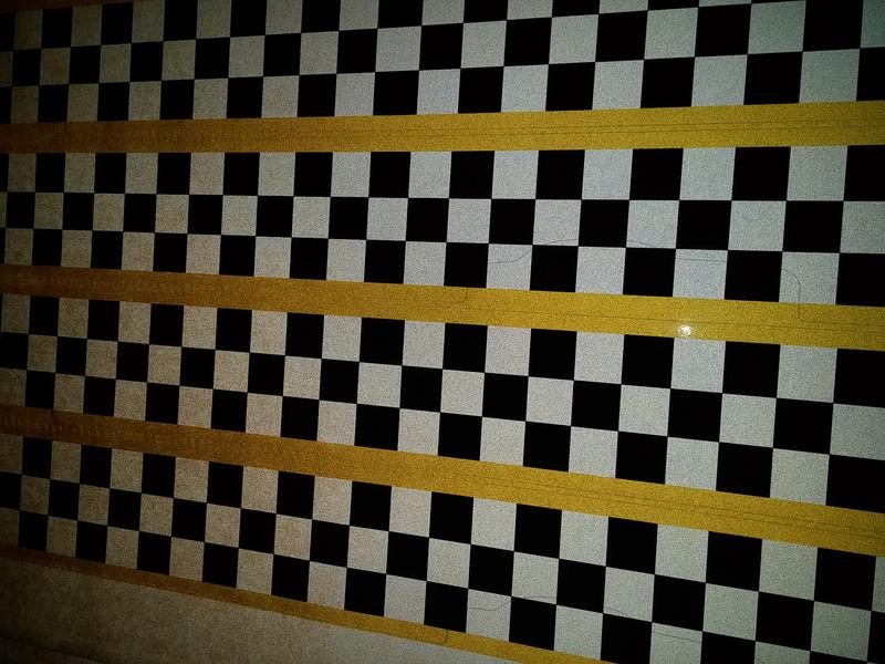

Try these.
They are sitting on my table waiting to go on Taxi Cabs.
First is in normal fairly bright fluorescent light.
Other two are with all lights off, its a windowless room, with my flash.
One at an angle and one more straight on. Taking a good pic of reflective is difficult.
The black is a 35/35/35/100 CMYK. If I used less "blackness" the black would be more reflective.
Its printed on 3M IJ5100 "white" on a Mimaki printer. YMMV
Note I'm not really trained in printing and color. I know how to cut anything, can print what our designer sends me and kind of understand Pantone Color so If I described something wrong please be gentle. :)

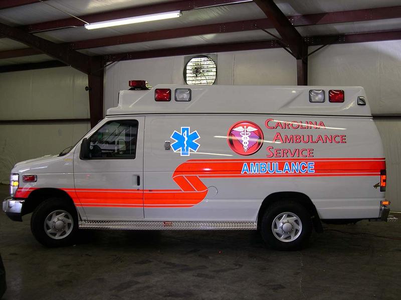

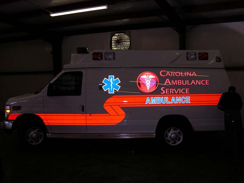

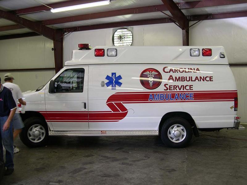

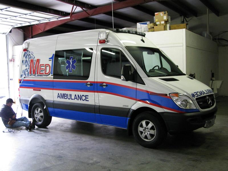

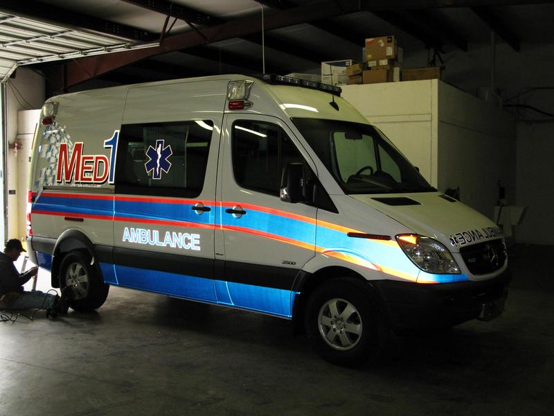

We do literally many many dozens of police, ambulance, fire apparatus, and other specialty things every year with printed reflective. The printed parts when reflecting have plenty of contrast with the unprinted parts and all of it lights up fine at night. We print all of it on our solvent Mimaki. Couple of examples with no flash and flash or variable lighting.
we see the same contrast values using Eco-Sol Inks. have always had plenty of ease of reading for night viewing
